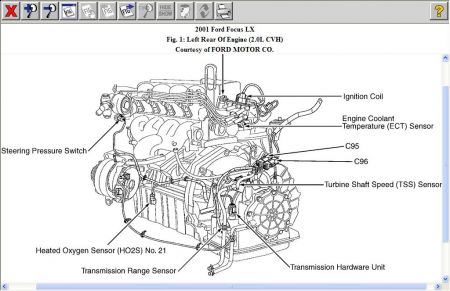

where is the temp cooling sensor on a 2001 ford focus se double overhead cam

ECT Sensor see below
