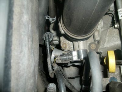

vMy focus keeps on accelerating the rpm goes way up without me pressing the gas then goes down. when I drive it also does it and it turns off like if it's lacking power or something. This is so irritating. I took it to a mechanic and he changed the intake manifold and some wires and charged me alot for this which didn't even fix the problem! I also changed the idle control valve and it still has the problem. I'm exhausted with this car! What is the problem it's still accelerating and turning off also the security light comes and off! Help! Now i even have a check engine light on. Please Help!

Ok so I went to pepboys now. lol. I got the codes. They gave me codes: P0122 Tp sensor and
P1120 Starter Switch Circuit could this be making my car accelerate like it is or does it have nothing to do with was happening. Thanks for you help.

Anyhow, there is definitely something wrong with your TPS sensor, and yes it is likely why you have acceleration problem. The TPS sensor senses how much your throttle plate is open. Basically when you press on the gas pedal, it pulls a cable that opens or closes this throttle plate. This sensor is one of the inputs used by the computer (pcm) to determine the proper AFR (air/fuel ratio).
Another thing: P1120 is not a Starter Switch Circuit problem. This code indicates your TPS is out of range.
This could be several things and before we blame a faulty TPS, I’d like to do some troubleshooting:

OK, we won't be able to do a lot of troubleshooting then. What you can do however is to check the wiring at the sensor, as well as the connector, for damage wire, short to ground, loose wire, etc. If it checks out OK, you'll have to go to a shop for further troubleshooting. At least you'll be able to tell them what's wrong and they won't take you for a ride. Here's a picture of the sensor in case you don't know where to look:
https://images.2carpros.com/forum/automotive_pictures/215217_UNI_0030_2.jpg
The picture is taken from the passenger side. You can see a yellow wire going to it; it's right below the big, black duct on the picture (on the left of it if you're looking standing in front of the car). Hope this helps.
