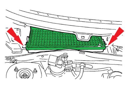

When I turn on my a/c this really bad smell comes out. I have had it looked at but nowone can find the problem. Also when I accelerate I can sometime hear water, it sounds like it's in the dash on the passenger side, and I was told that there is no water spot on the ground after the a/c has been running. What is it and how do I fix it. summer's are really hot in Texas!!

can you describe the smell a little better? moldy? antifreeze scent?

I guess,it smells like mold.

try a new cabin air filter first and try spraying a solution of bleach through the air vents then turn the blower on, that might solve it if not your valve that bleeds off the water vapor is plugged and keeping the water in the ducts.

Can you tell me where the cabin air filter is located? Also, the bleach helped a lot. I filled up with freon and now I have the water drip under the car (as it should do.)

did you call !! check under hood if you have one it will be on the write side check the picture
https://images.2carpros.com/forum/automotive_pictures/99387_focuscabin_1.jpg

your welcome, thank you for your politeness.
and thanks bmr for the image.
