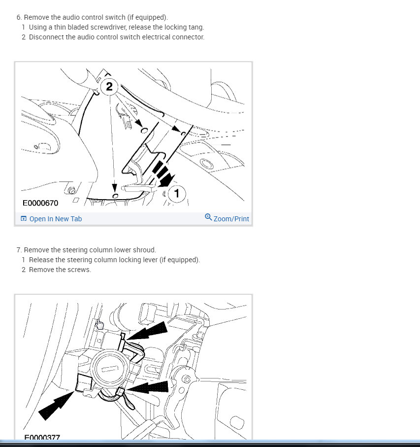

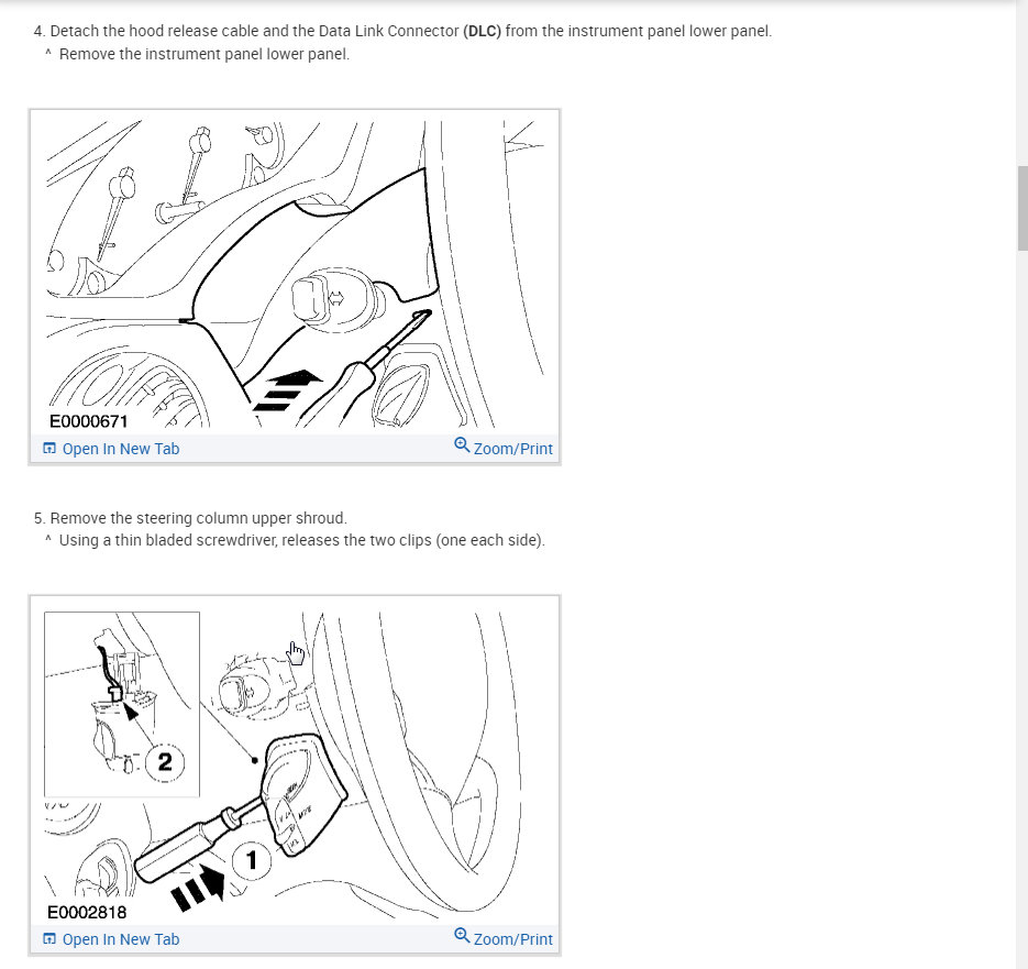

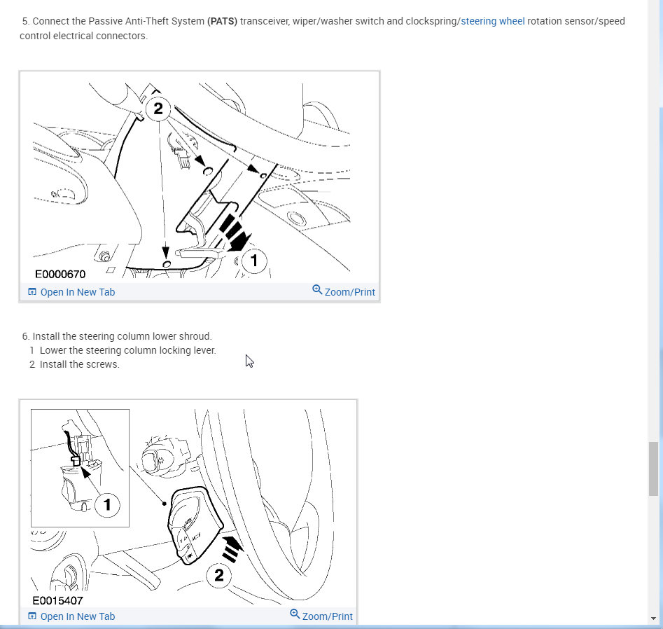

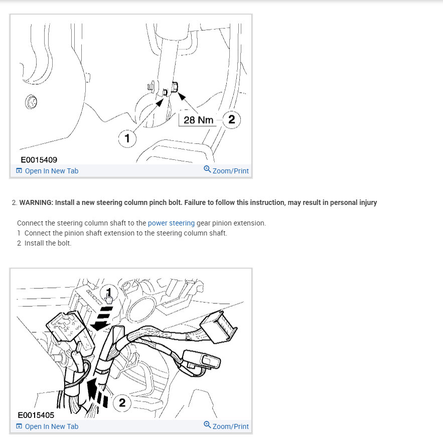

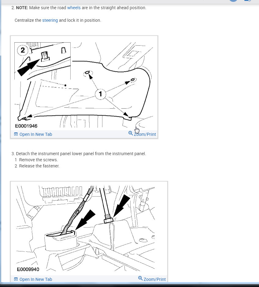

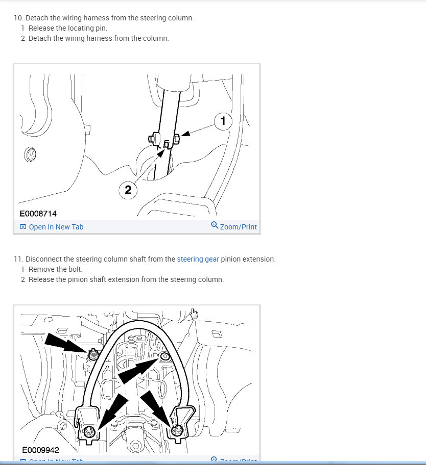

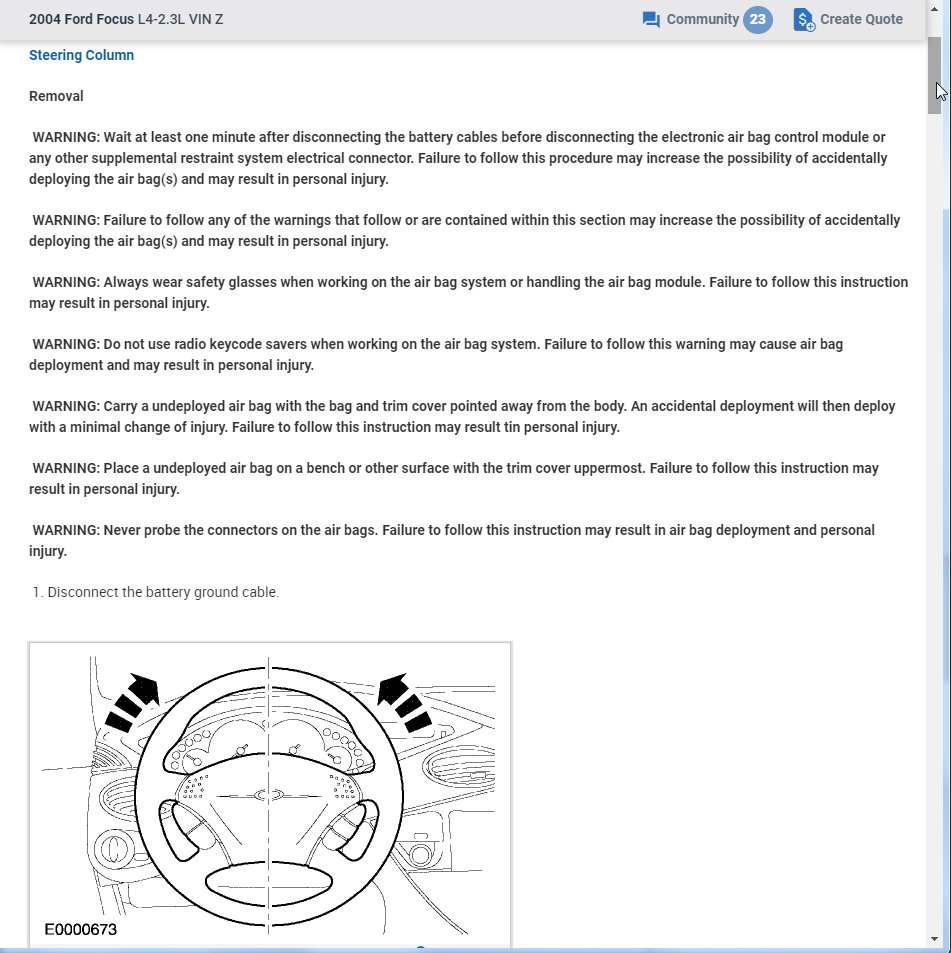

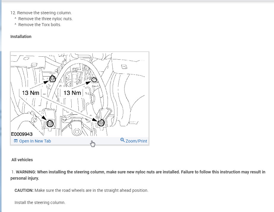

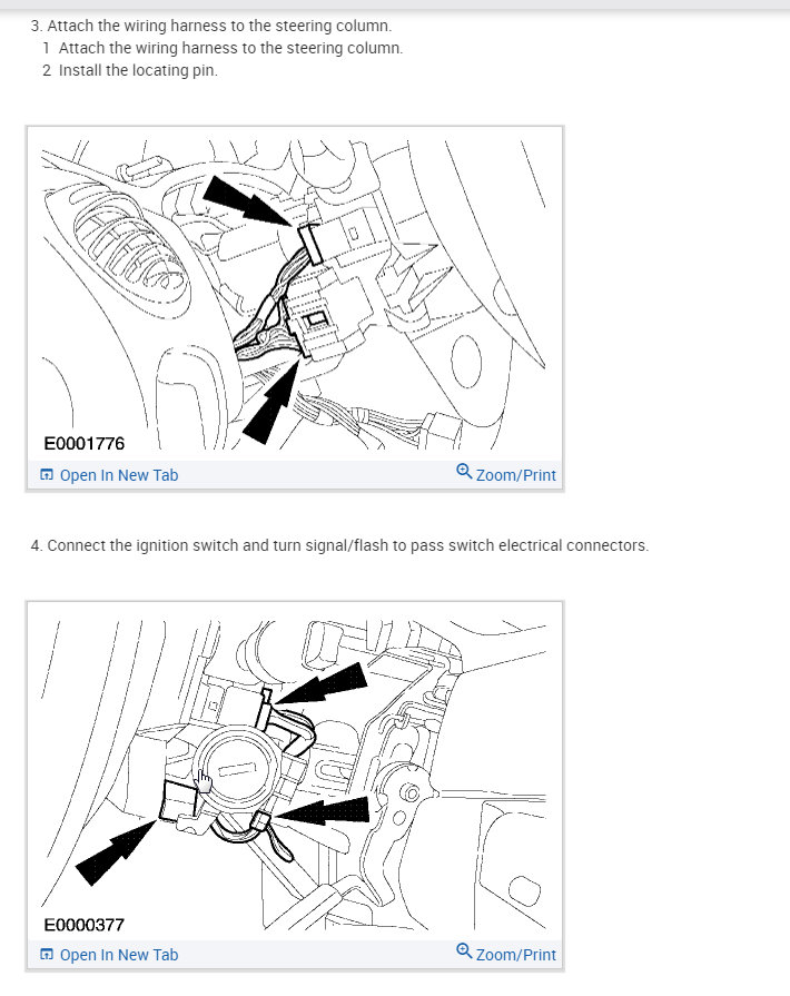

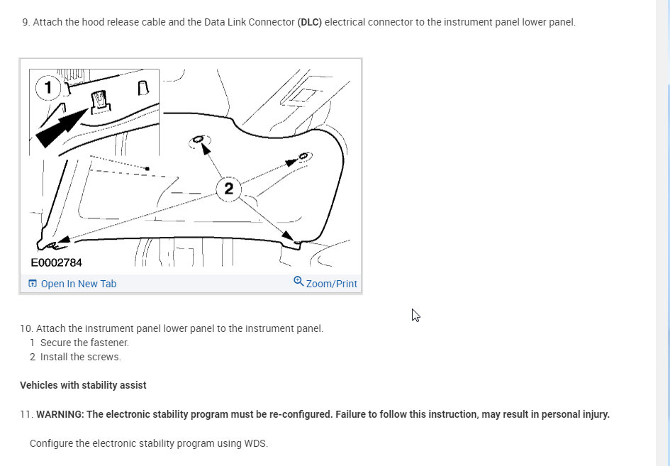

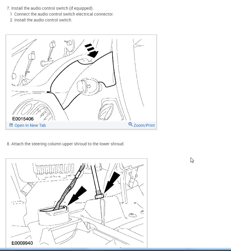

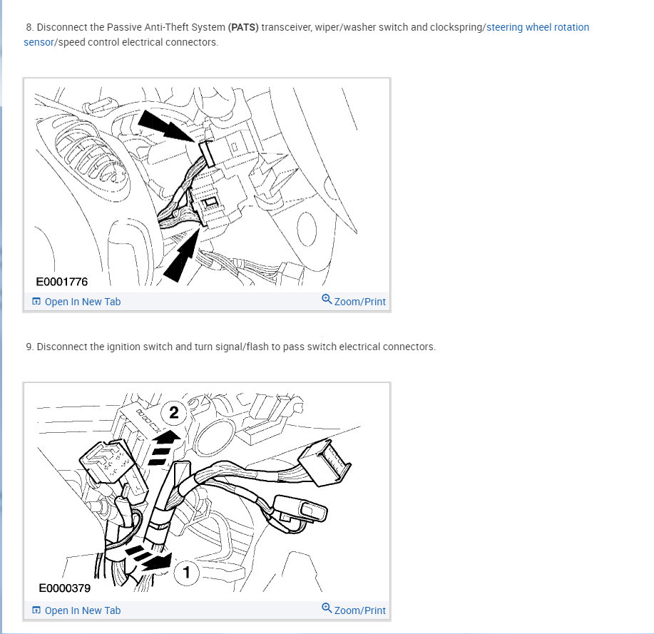

Okay. That helps. I attached the process for replacing the column as I suspect that is where the noise is coming from. However, I am not suggesting that you replace the column. I am providing this info so you can disassemble the column to the point of being able to see or hear better where the noise is coming from. I suspect it is one of the joints on the steering shaft but once these panels are out of the way, you will better be able to tell.
