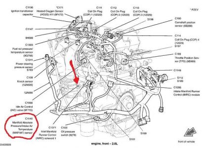

I need to find out where the MAP sensot is fitted on the Duaretc 2.0L. My car suffers from poor cold start and irratic idle for the 1st minute or so. Once it warm it idles fins, although it does hunt a bit.
I have replaced plugs, plug leads and cleaned injectors. My fuel consumption is also higher than normal and peformance is down.

Manifold Absolute Pressure/Intake Air Temperature (MAP/IAT) Sensor (2.0L)....On intake system.
https://images.2carpros.com/forum/automotive_pictures/266999_fiesta_2.jpg
