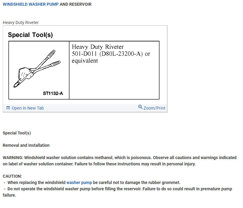

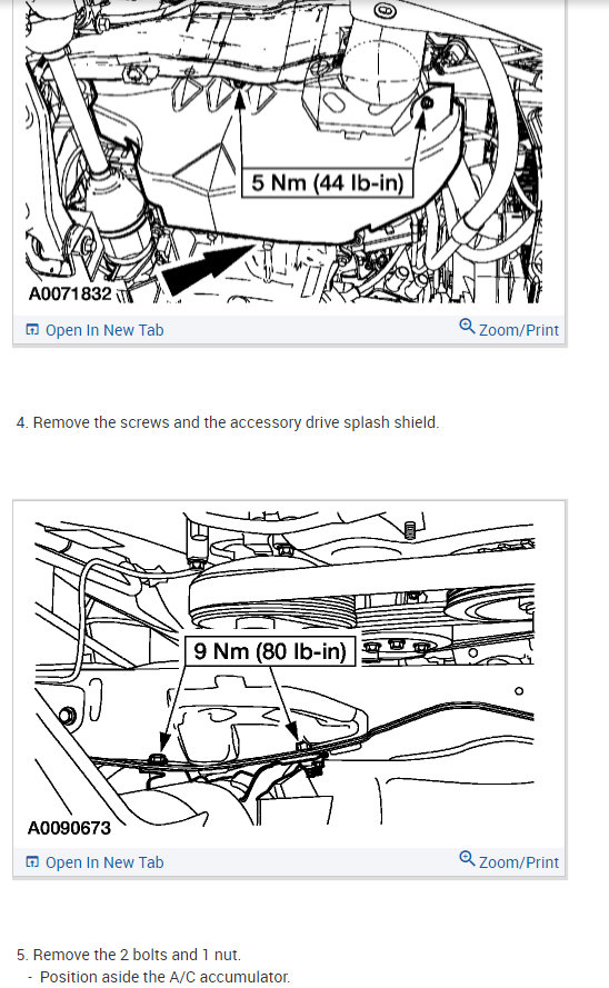

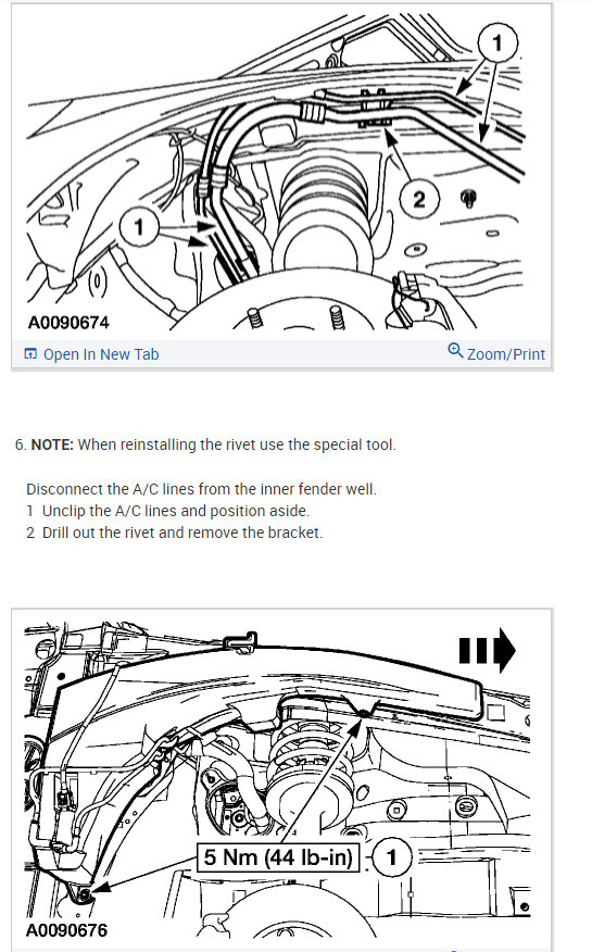

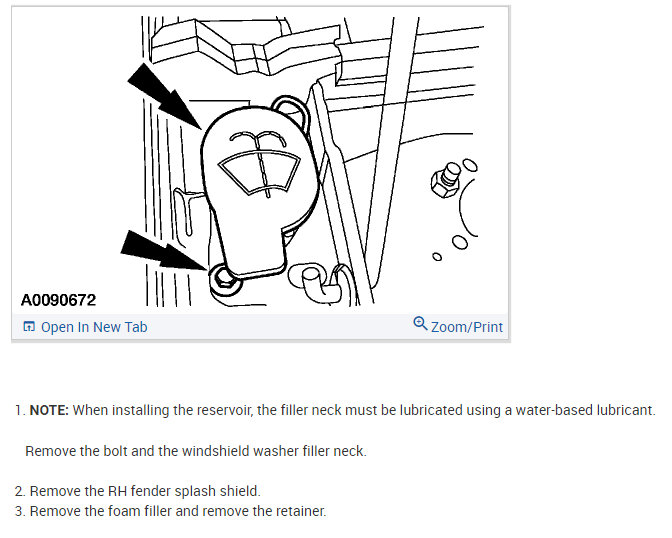

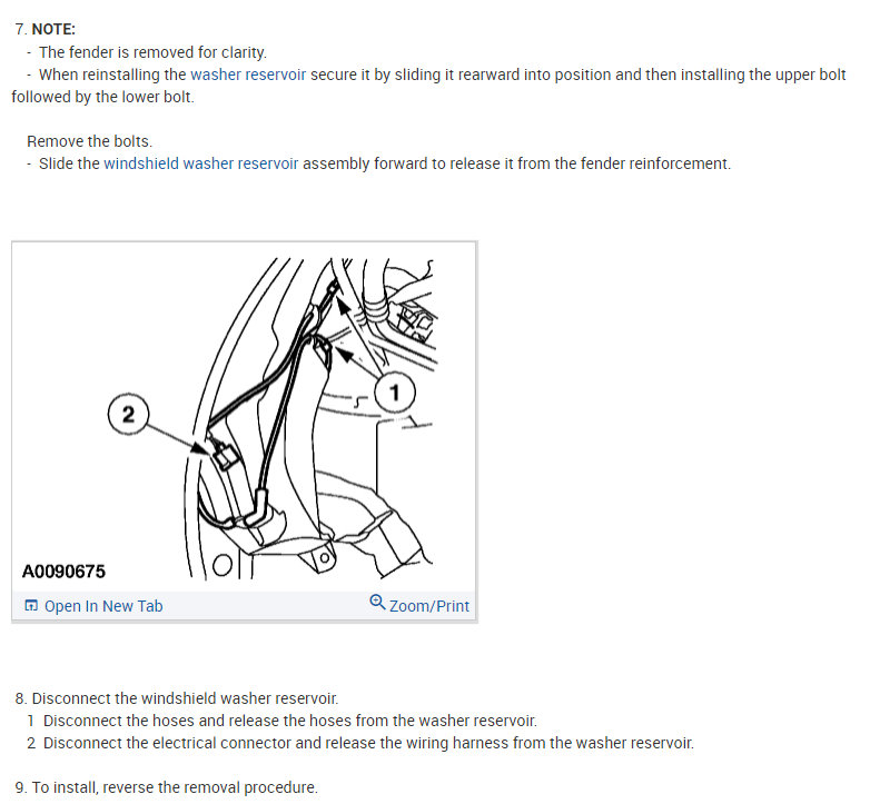

Here is a helpful article about replacing the pump:
https://www.2carpros.com/articles/how-to-replace-a-windshield-washer-pump
