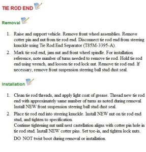

Steering problem
1997 Ford Fiesta 4 cyl Front Wheel Drive Manual
how do you remove and replace a near side track rod end on a ford iiesta 1997
May 19, 2010 at 6:27 AM
BLUELIGHTNIN6
  • 16,542 POSTS
https://images.2carpros.com/forum/automotive_pictures/261618_Noname_2205.jpg
