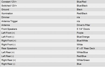

i have a ford festiva 1997
the radio harness has been cut off and i want to put a new radio in?
Can you tell me what the colour codes on the cable stnd for?
the wires are:
Black
Yellow
Green/orange stripe
Green/red stripe
Brown/red stripe
Brown/black stripe
Red/black stripe
Blue/red stripe
Blue/green stripe
Blue/white stripe
Blue/yellow stripe
Blue/black stripe
Blue/orange stripe
THANKS

None of my databases show anything for festiva, must be import/export vehicle, I'm in the US. I don't know if escort would have close to same wiring? If you get new radio, wouldn't instructions have wire applications? The info below is for ford escort, don't know if the same?
https://images.2carpros.com/forum/automotive_pictures/170934_radio_wire_colors_1.jpg
