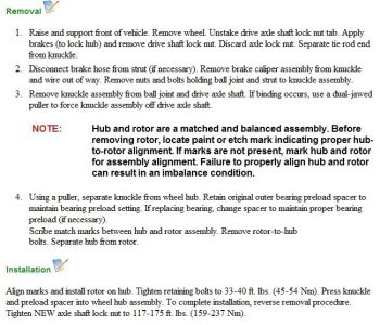

1993 Ford Festiva how do you remove the brake rotors front
1993 FORD FESTIVA
FESTIVAHELP
1993 Ford Festiva 4 cyl
what is the trick to removing the brake rotors? do you need a special tool?
Dec 7, 2009 at 11:00 AM
BLUELIGHTNIN6
  • 16,542 POSTS
https://images.2carpros.com/forum/automotive_pictures/261618_Noname_2038.jpg
