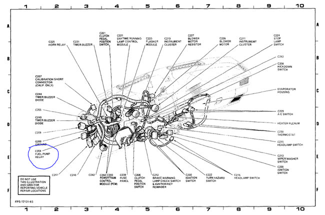

Where exactly is the fuel pump relay switch located? I recently tried to get my car to start after sitting idle for eight years due to motor problems. I installed another engine out of a 1991 Festiva and replaced all gaskets and timing belt, installed new electric fuel pump, but it will not pump fuel up the gas line! The only negative thing I did was not draining the old gas out of the tank, since it only had about two or three gallons in it. I put a can of Sea Foam and added five gallons of gas to the tank.

The fuel pump relay is near the drivers side kick panel. Here is a guide to help you test it and the location of the relay in a diagram below:

I checked the fuel pump and it works great. I replaced the fuel relay and I reset it? I do not know what is wrong with it. I traced wires but it got confusing for me so any input will be so helpful. Thank you.

Check the computer if it is grounding the coil side of the relay.
