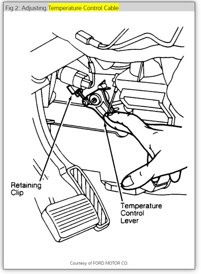

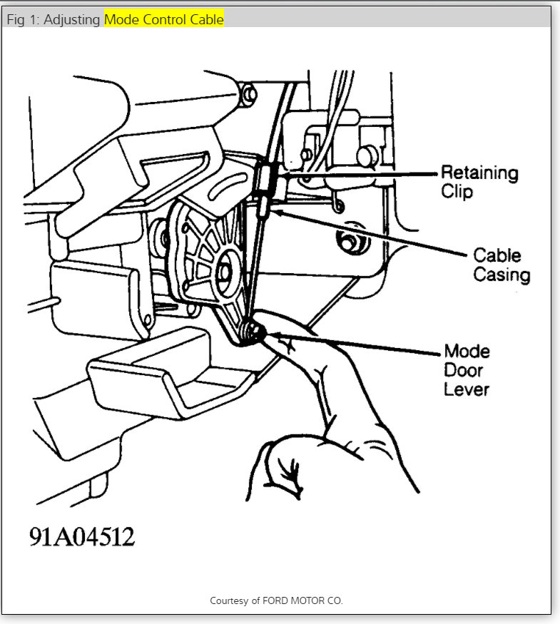

No heat from front vents
1992 FORD FESTIVA
ANICKM3
4 cyl Front Wheel Drive Manual 103918 miles
When I turn the heat on, it will blow hot on floor and windshield vents, but when I set the lever to front vents the air is cold. I found a person with the same problem, he said it just started doing this on his car one day, that before it would blow hot on front vents. Can you help?

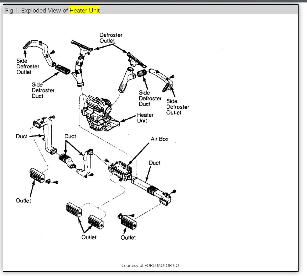

It sounds like you have a temperature or mode blend door problem. I would check the operation of the control cables to see if one has fallen off or needs adjustment. Here are some diagrams (below) so you can take a look at whats going on (below)
This guide may help as well
