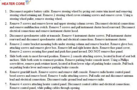

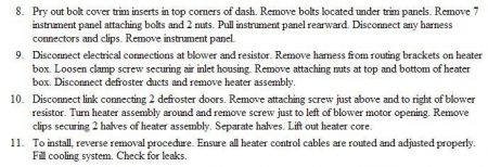

where can i find a free schematic of the heater core removal ?

https://images.2carpros.com/forum/automotive_pictures/261618_Noname_1178.jpg
https://images.2carpros.com/forum/automotive_pictures/261618_Noname2_345.jpg
