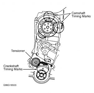

1991 Ford Festiva timing belt, diagram?
1991 FORD FESTIVA
REBELCHILD
Engine Mechanical problem
1991 Ford Festiva 4 cyl Two Wheel Drive Manual
need to get car timed and not sure how...just put new crank shaft seal and now wont start....what do i do?
Sep 25, 2008 at 8:09 PM
OBXAUTOMEDIC
  • 3,711 POSTS
Hello, Here is the timing alignment....
https://images.2carpros.com/forum/automotive_pictures/188069_91festivatimbelt_1.jpg
