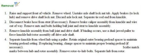

Brakes problem
1990 Ford Festiva 4 cyl Front Wheel Drive 172000 miles

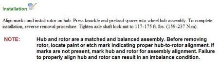

what is the easy way to remove the rotors on my festiva I'am not sure how I know youhave to take the nut off but does the axel have to come out .

Proper replacement procedures are as follows:
https://images.2carpros.com/forum/automotive_pictures/261618_Noname_338.jpg
https://images.2carpros.com/forum/automotive_pictures/261618_Noname2_94.jpg
