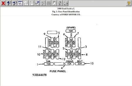

my blinkers and seat belts and gear shift stoped working after i accidently touched a ripped wire to metal. is it a fuse and were is it located?
May 9, 2008 at 4:31 PM
  • 75,992 POSTS
Tape the bare wire Inspect and test fuse no.3 and no.11 see below
https://images.2carpros.com/forum/automotive_pictures/12900_fuse_3.jpg
