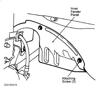

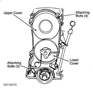

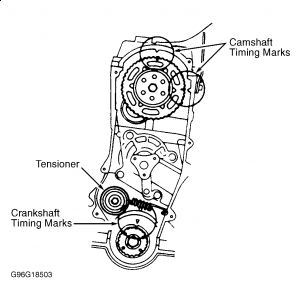

How do i replace the timing belt and what are the locations for the timing marks. what is the valve lash on the exhaust and the intake valves. it has manual rockers. thank you dave
Oct 13, 2009 at 6:31 PM
DOCFIXIT
  • 18,828 POSTS
Hi Remove inner fender panel to get at crank bolt. then remove front engine covers. put engine TDC and loosen tensioner remove belt. Reverse to install. Intake and exhaust valves clearence .012 in.
