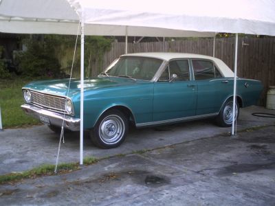

rebuilt 200 straight 6 motor runs great,but will not charge. holds charge when parked, new alt.,batt.,volt reg. checked continuety from alt .through starter relay yo volt reg. but still wont charge . so right now i have a beautiful electric car.. help any suggestions??? thanks tommy[img:1040dc2e0d]http://www.2carpros.com/forum/automotive_pictures/567547_tbird3_001_2.jpg[/img:1040dc2e0d]
