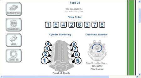

I'm trying to find out the firing order for a 302 windsor

Never heard of a 302W but a 351W
https://images.2carpros.com/forum/automotive_pictures/12900_fo1_5.jpg
