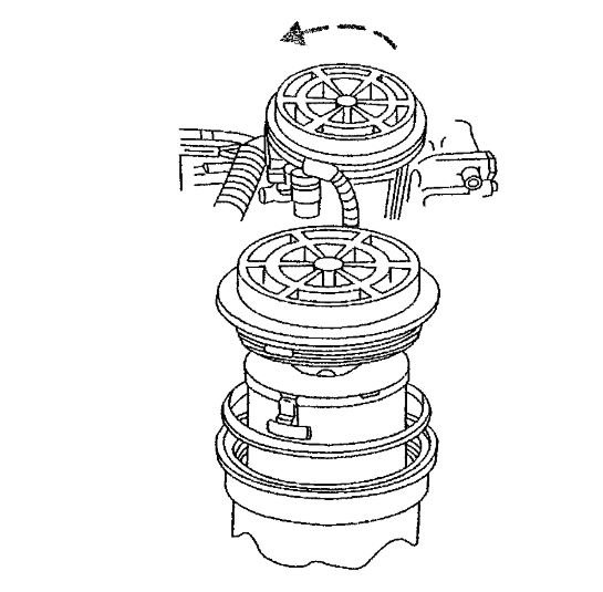

Good afternoon,
Is your filter on the top of the motor or under the truck on the left fuel rail?
I attached a picture of the filter mounted on top and need to know if this is the system you have.
