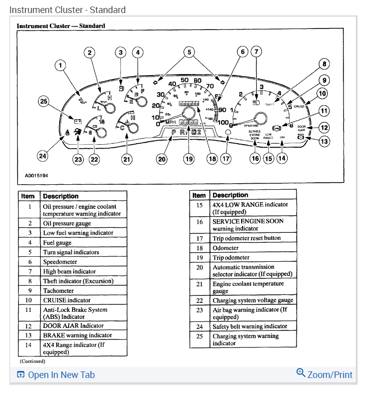

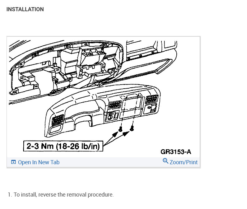

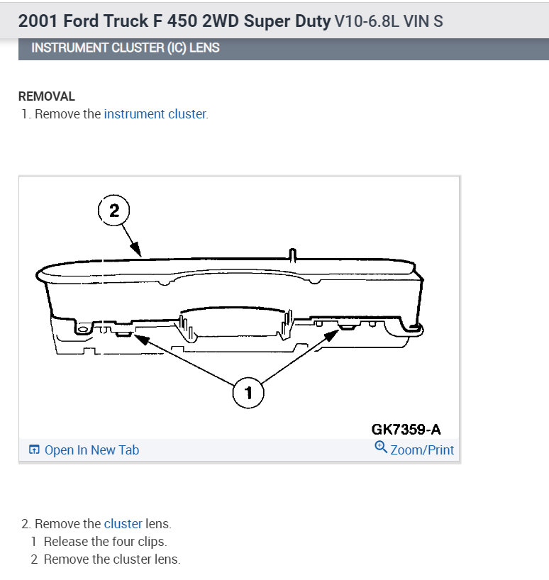

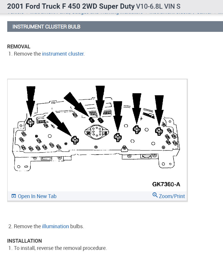

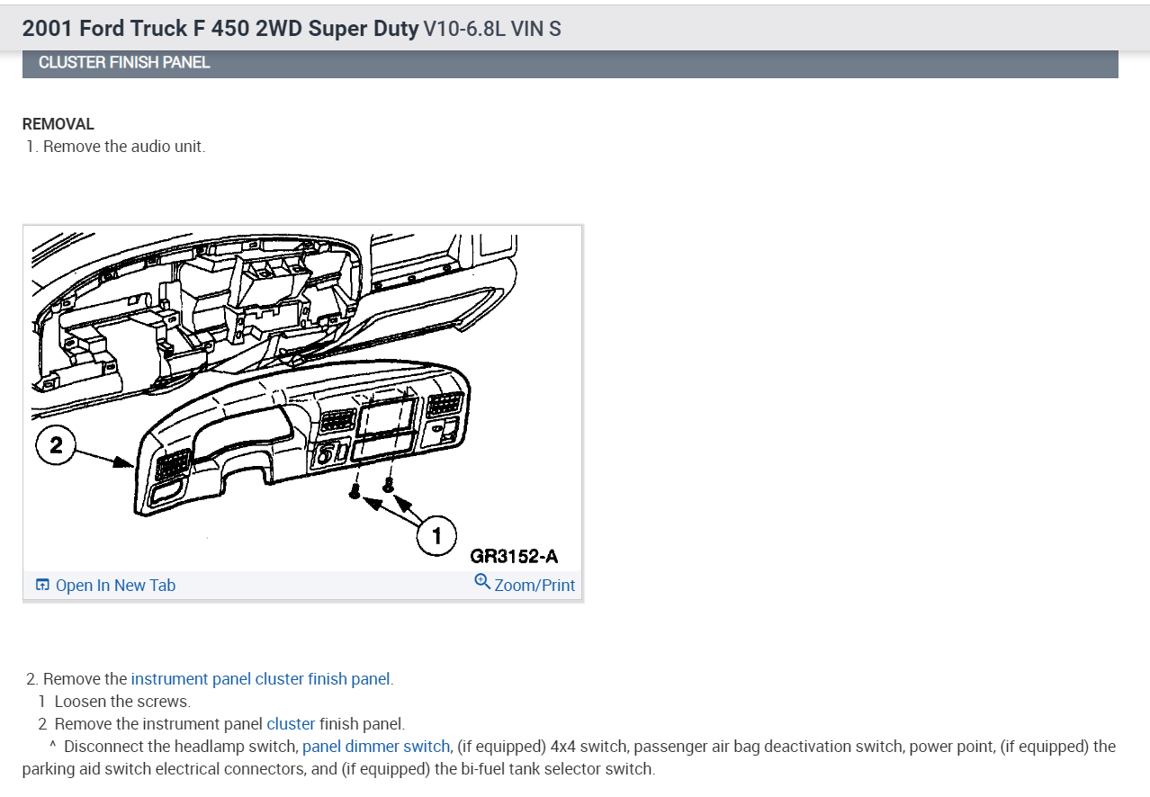

Here is how to change out the instrument panel light bulb in the images below. Check out the images (Below). Please let us know if you need anything else to get the problem fixed.
