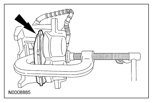

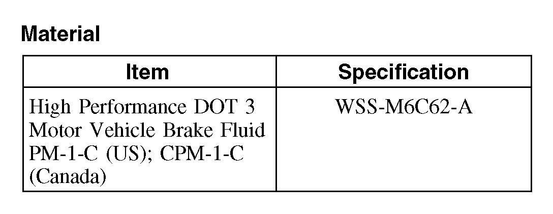

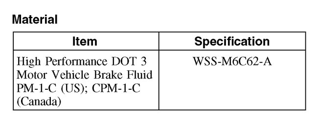

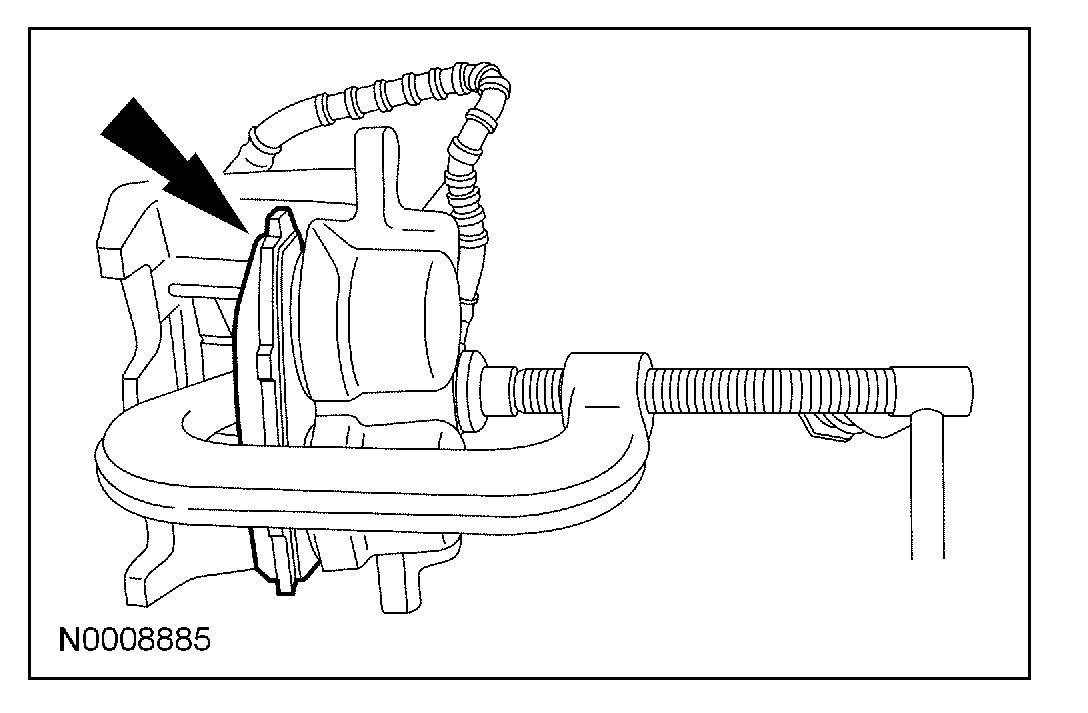

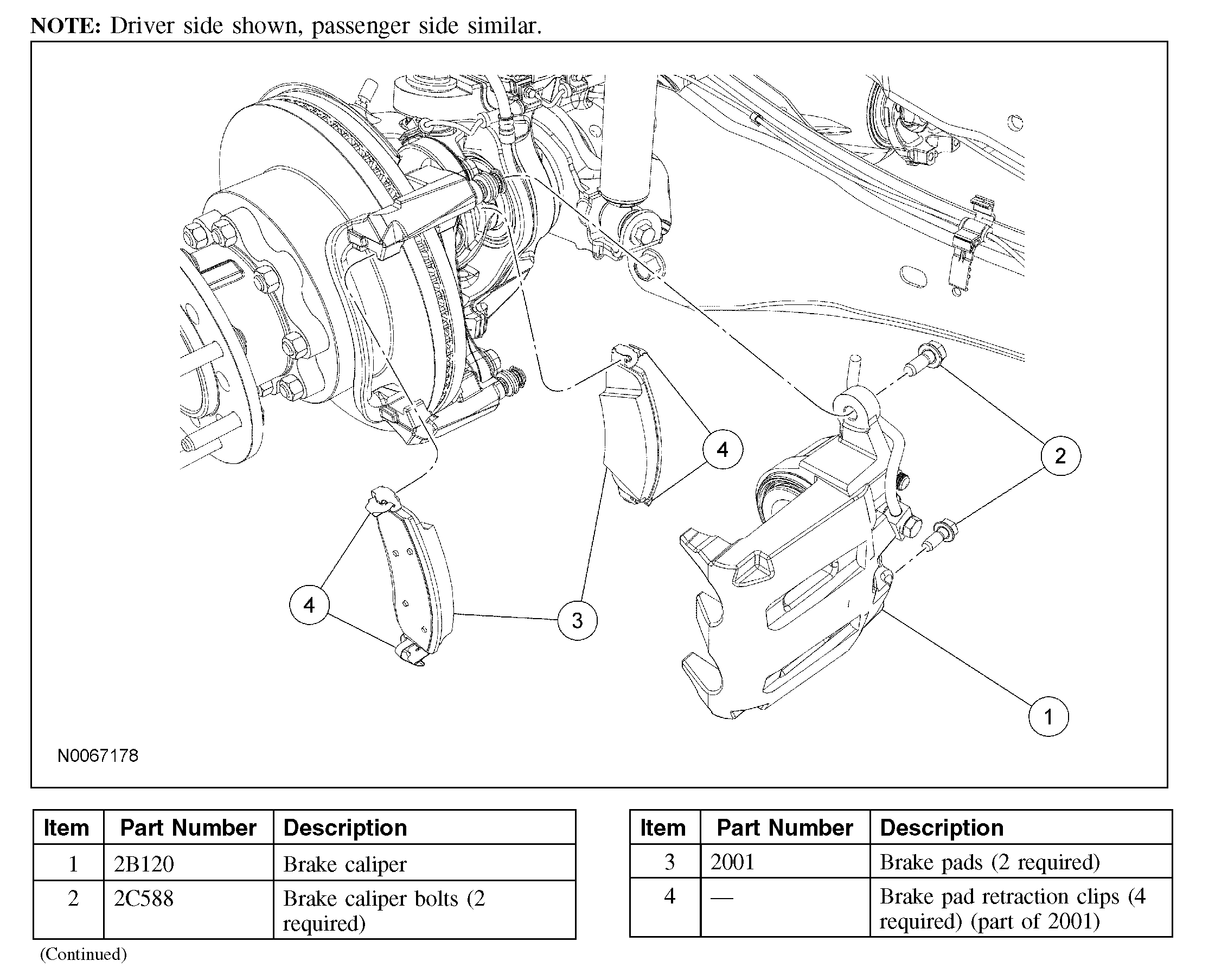

brakes chips, etc, do you recommend for pads?
Jul 2, 2010 at 3:14 AM
  • 110,240 POSTS
Hi:
Replacing brakes isn't too hard to do. First, here is a link that explains in general how it's done. You can use these as a guide.
Here are the directions specific to your vehicle. The attached pics correlate with the directions.

Brake Pads
Material
pic 1
pic 2

Remove the 2 brake caliper bolts and position the caliper aside.
^ Support the caliper using mechanic's wire.
4. WARNING: Always install new brake shoes or pads at both ends of an axle to reduce the possibility of brakes pulling vehicle to one side. Failure to follow this instruction may result in uneven braking and serious personal injury.
Remove the 2 brake pads and 4 retraction clips.
^ Discard the 4 retraction clips.

Install the 4 new retracting clips and the 2 brake pads.
2. CAUTION: Protect the piston and boots when pushing the caliper piston into the caliper piston bores or damage to components may occur.
If installing new brake pads, using a suitable tool and a worn brake pad, compress the disc brake caliper pistons into the caliper.
pic 3

Position the brake caliper and install the 2 bolts.
^ On F-250, F-350, tighten to 76 Nm (56 lb-ft).
^ On F-450, F-550, tighten to 63 Nm (46 lb-ft).
