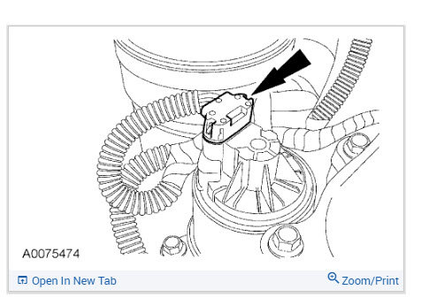

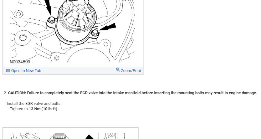

where is the EGR valve located on the truck listed above with a 6.0 power-stroke v-8?
Jun 26, 2009 at 6:19 AM
BLUELIGHTNIN6
  • 16,542 POSTS
The EGR valve should be seated in the intake manifold held by two bolts.
https://images.2carpros.com/forum/automotive_pictures/261618_Graphic_5.png

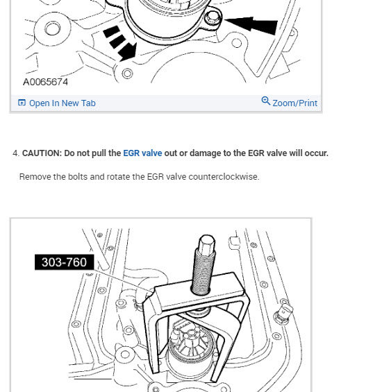

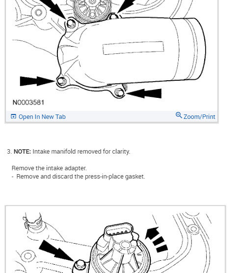

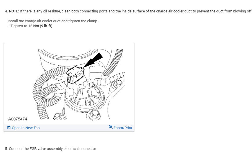

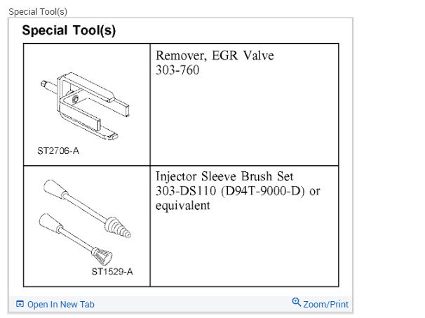

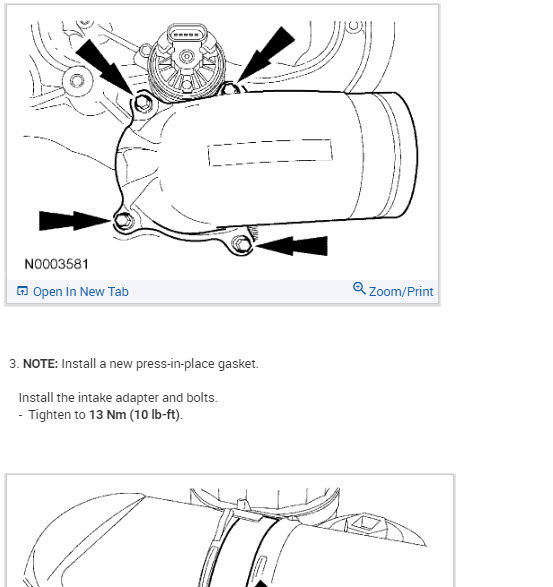

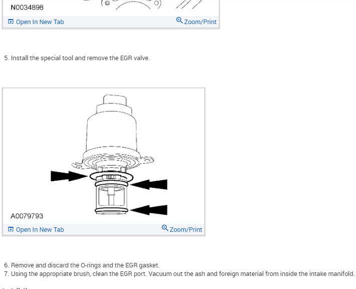

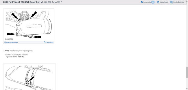

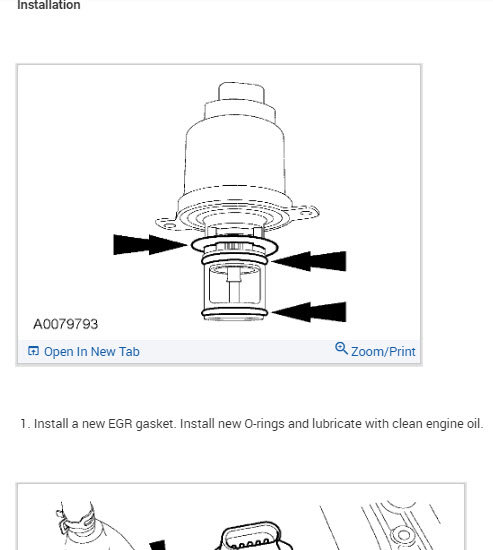

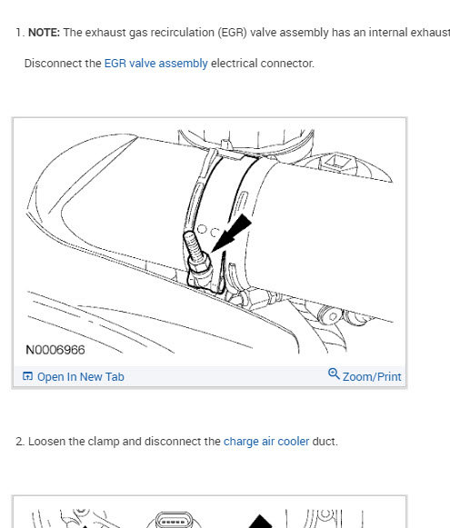

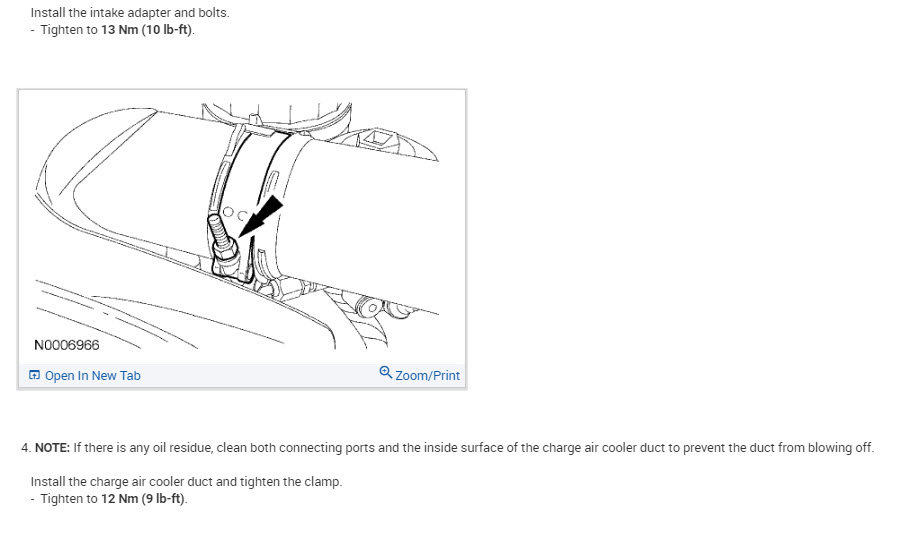

There are special procedures for removing the valve because of excess carbon build-up. I have attached the procedure and special tool numbers.
