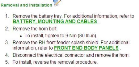

my started sticking on and then finally blew the fuse i have replaced with good fuse and can hear clicking that sounds like a relay but it is not any of the relays in the fuse block under the dash sounds like its coming from there ?? or under the dash near there i have looked for the horn under the hood and can not locate it any where ?? so where do i fiind the horn it self or what should be the next step in trouble shooting this looking for your reply Gerry

welcome to the forum, the database showed the above info for getting at the horn. The horn relay shows to be in the central junction box, lower left side of dash.
