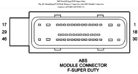

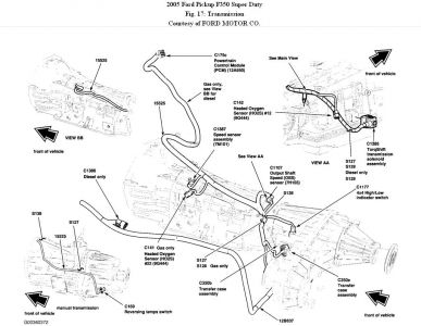

I'm installing an after market stereo - Pioneer AVIC-X920BTS and I have two wires to hook up and I don't know where to find the source to hook them up to. One is a speed signal input (for GPS accuracy) and the other is the reverse gear signal input. Can anyone help me here?

Hi atcontrolr, Thank you for the donation. The speed signal is to be attache to the Speed Sensor Assy wiring whereas the back-up can be spliced at the reverse switch or its wiring.
https://images.2carpros.com/forum/automotive_pictures/192750_SensorTrans05F350Fig17_1.jpg
What is your engine capacity?

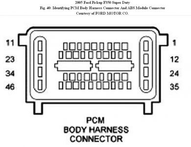

I have a 2005 Ford F-350, crew cab, long bed, 6.0L diesel. Where can I conveniently tap into the speed signal, reverse gear signal, and parking brake power supply side

For diesel the system is different. The VSS is supplied by the ABS module. You either tap it from PCM Pin # 35 or ABS module Pin # 21 (Gray/Black wire).
https://images.2carpros.com/forum/automotive_pictures/192750_PinPCM05F350Fig40a_1.jpg
https://images.2carpros.com/forum/automotive_pictures/192750_PinPCM05F350Fig40b_1.jpg
. For reverse signal, you can tap it from terminal # 2 of the reverse lamp relay, in central junction box, behind left side of dash. There are 2 wires going into the parking brake sensor. The wire you need to tap in to should be green with a red stripe
