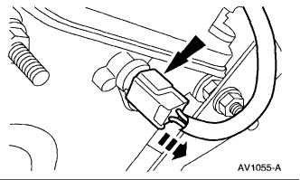

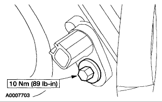

Where is the cam positioning module and how do i change it out

2004 Ford Truck F 350 4WD Super Duty V8-5.4L SOHC VIN L CAMSHAFT POSITION (CMP) SENSOR REMOVAL 1.Disconnect the battery ground cable.
https://images.2carpros.com/forum/automotive_pictures/12900_cmp1_1.gif
2.Disconnect the camshaft position (CMP) sensor electrical connector.
https://images.2carpros.com/forum/automotive_pictures/12900_cmp2_1.gif
3.Remove the bolt and remove the CMP sensor. INSTALLATION 1.To install, reverse the removal procedure.
