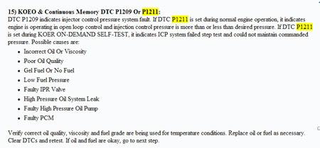

i have a couple codes coming up on my computer diagnostic scanner that aren't listed. codes are p1211 and p1249. if anybody could help me out with this, it would be greatly appreciated.

1211= injector control pressure system fault. 1249=wastegate steady state failure.
https://images.2carpros.com/forum/automotive_pictures/62217_1211_1.jpg
