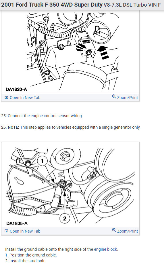

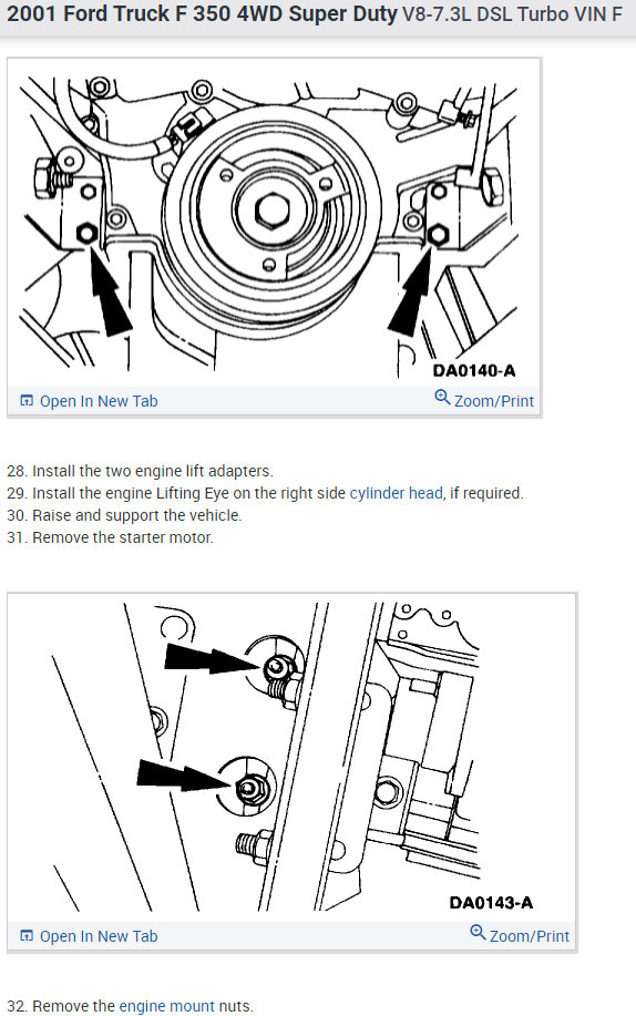

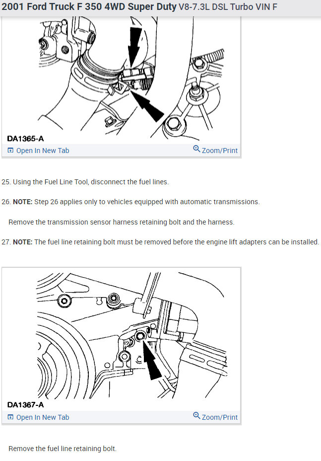

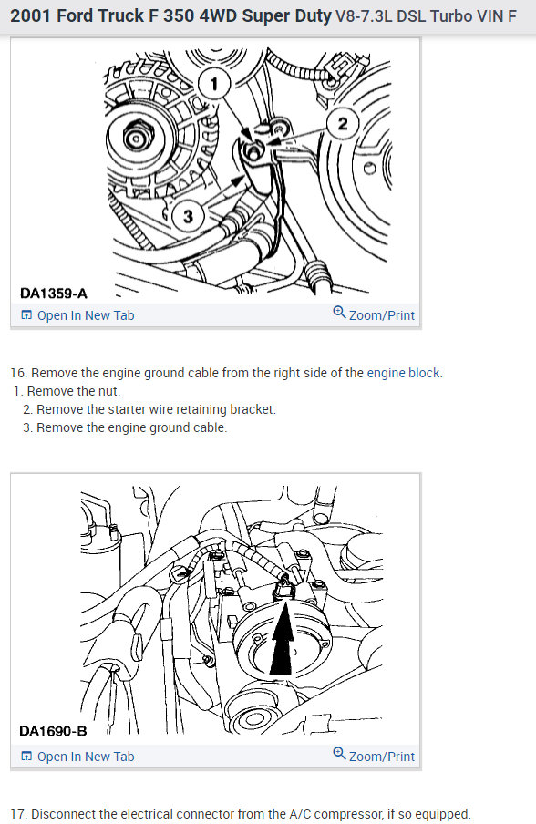

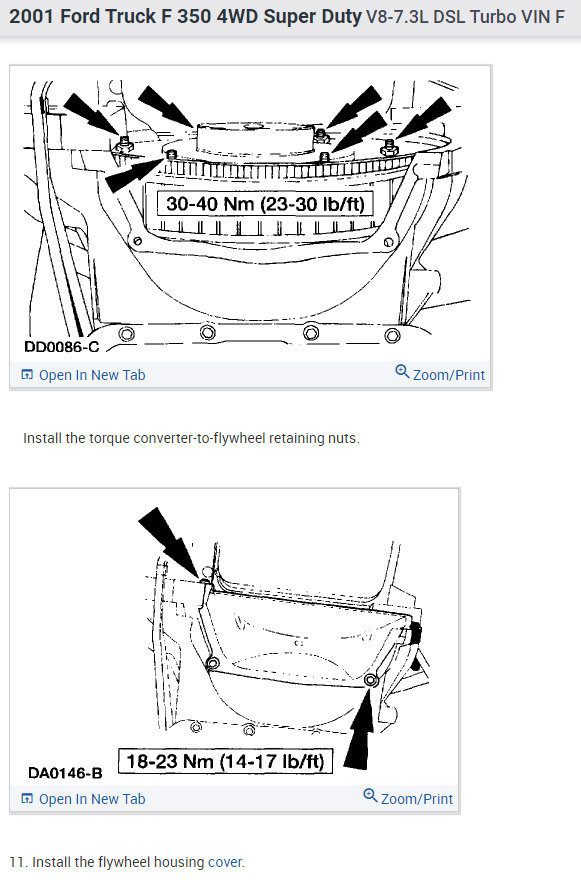

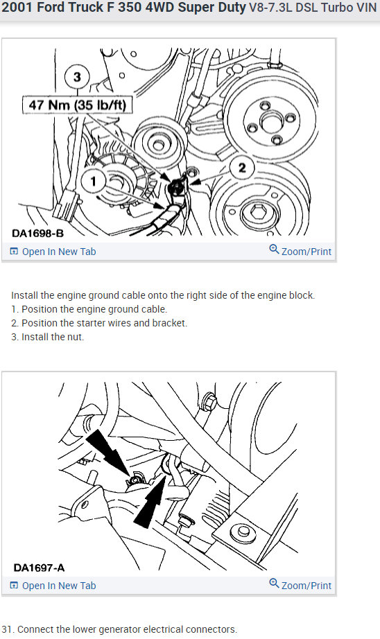

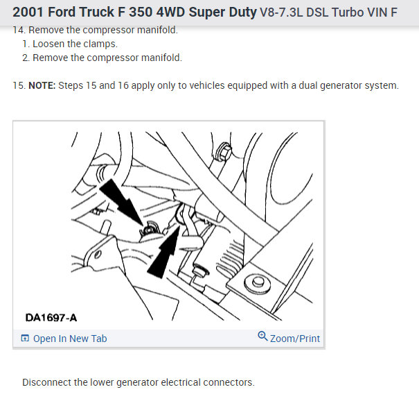

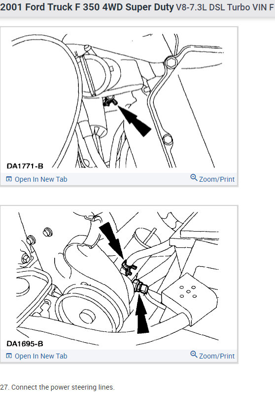

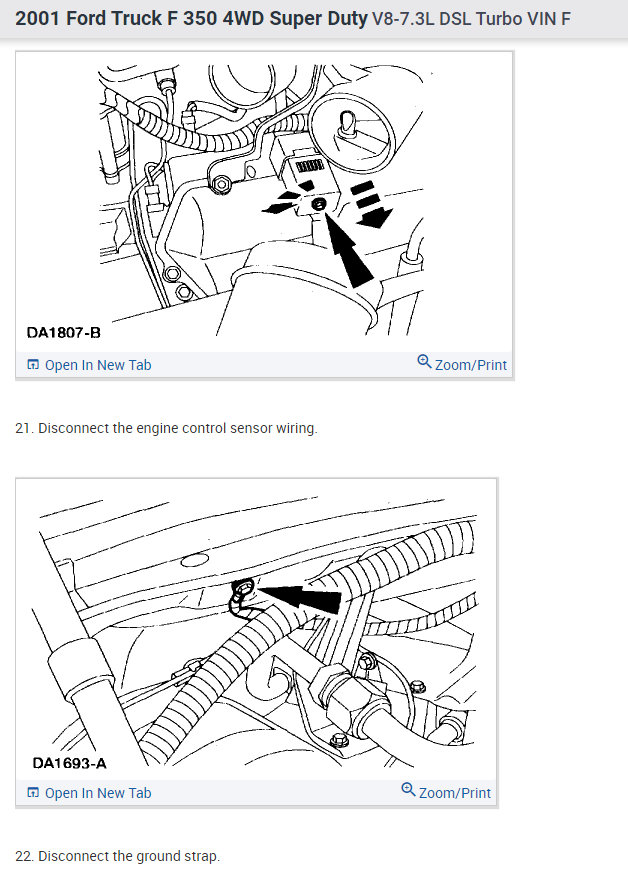

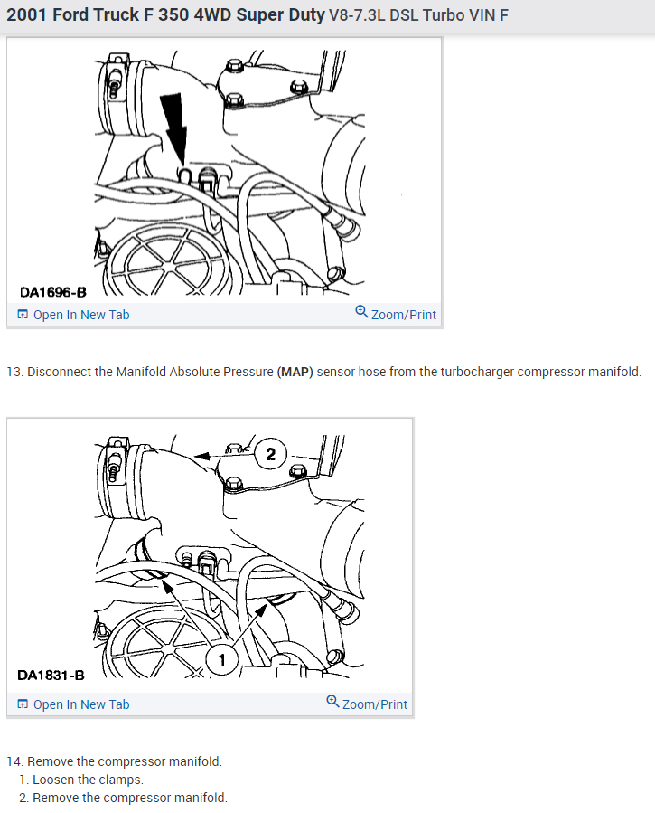

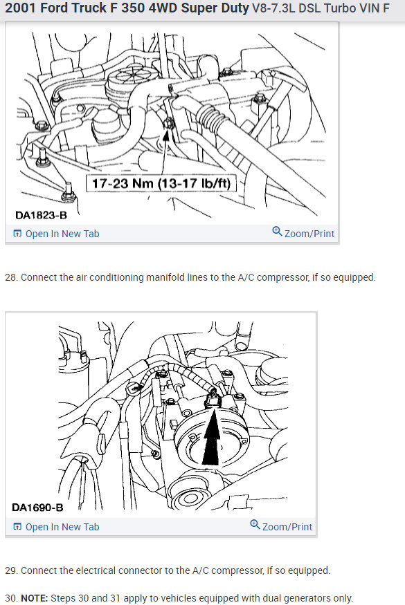

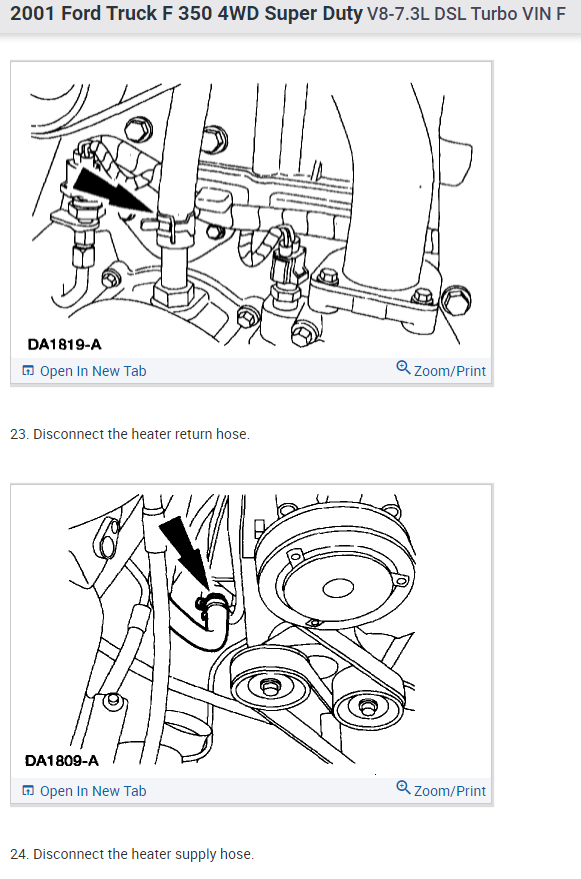

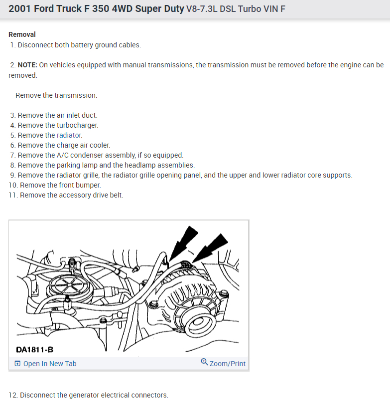

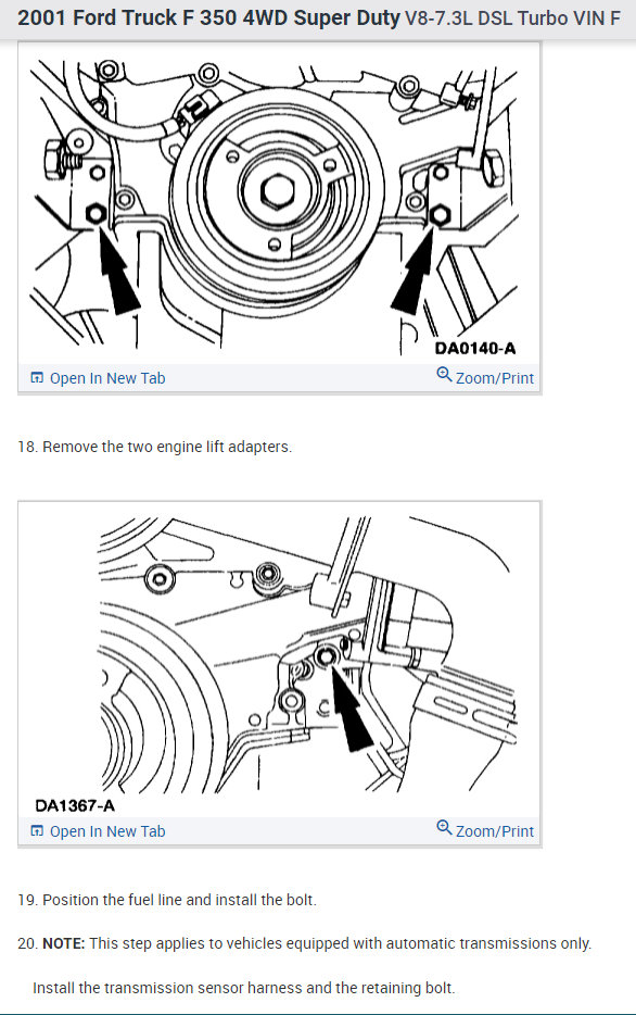

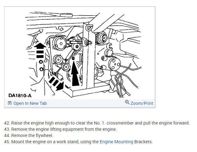

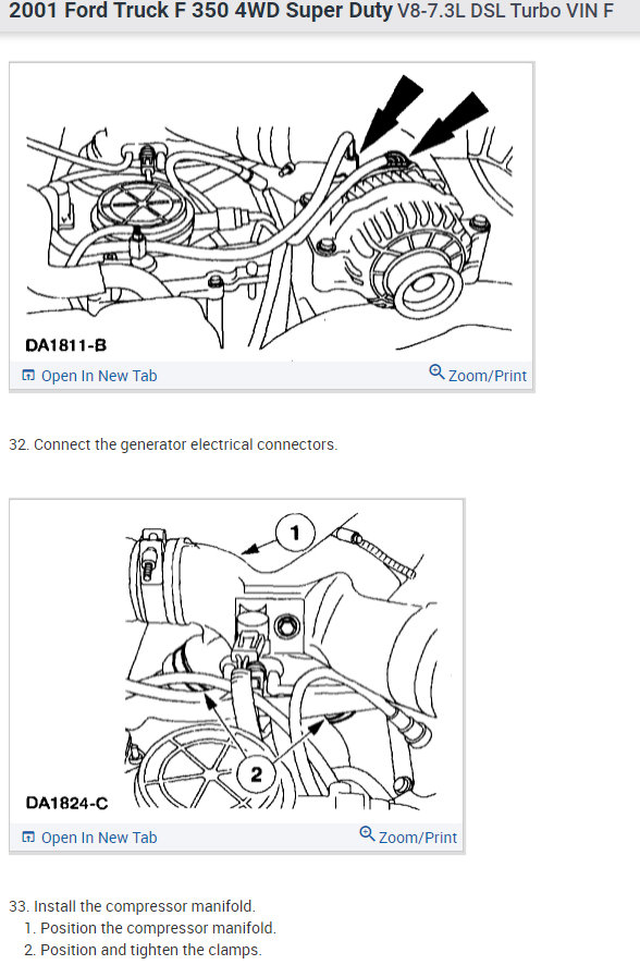

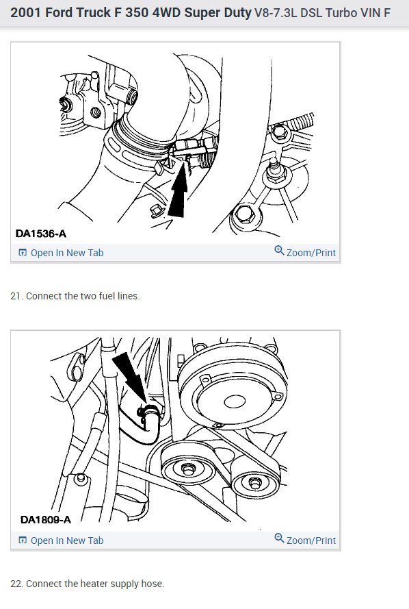

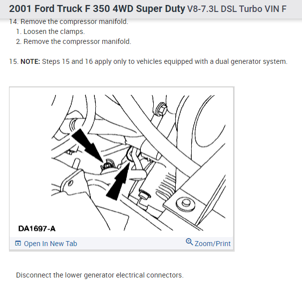

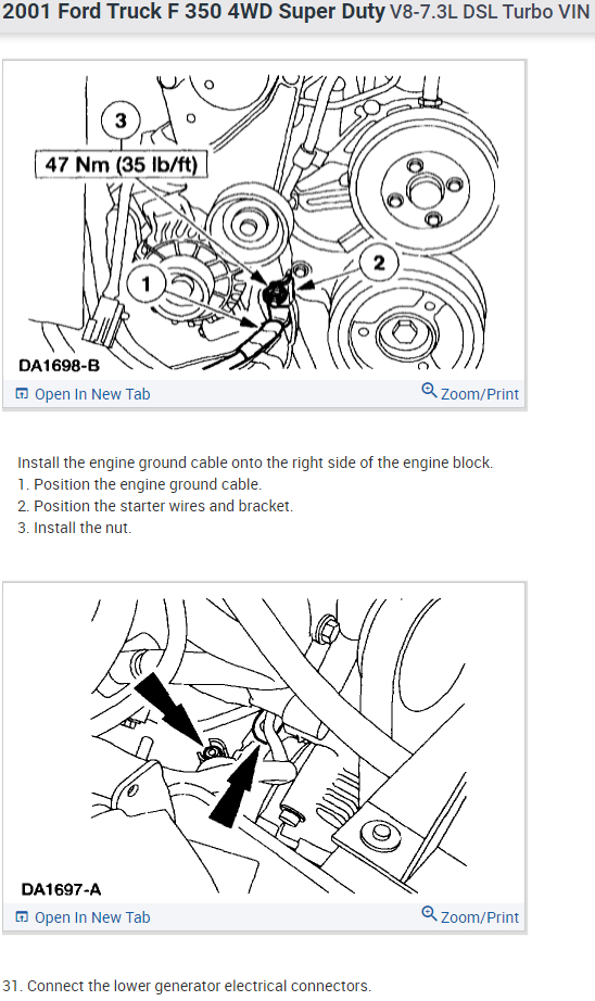

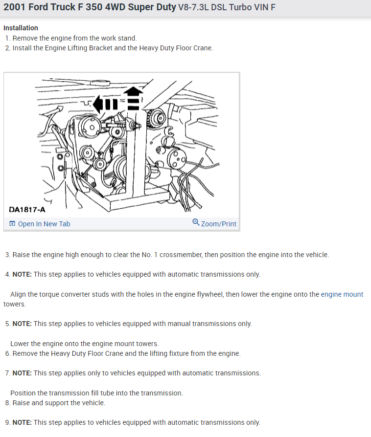

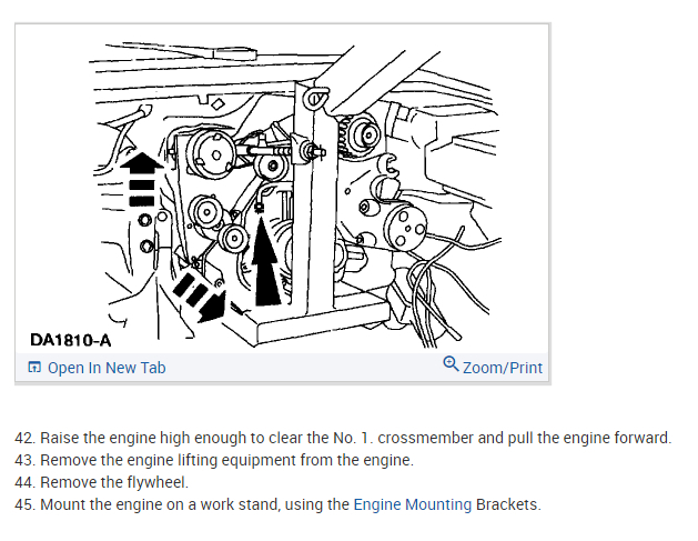

I need to replace my engine it's the 7.3 What I wanted to know is do I have the clearance to remove the engine by removing the turbo or do I need to lift the cab off the frame? I looking for the best way thanks
Sep 10, 2008 at 3:24 PM
SQM
  • 6,383 POSTS

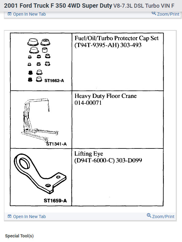

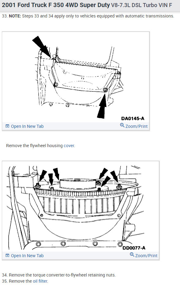

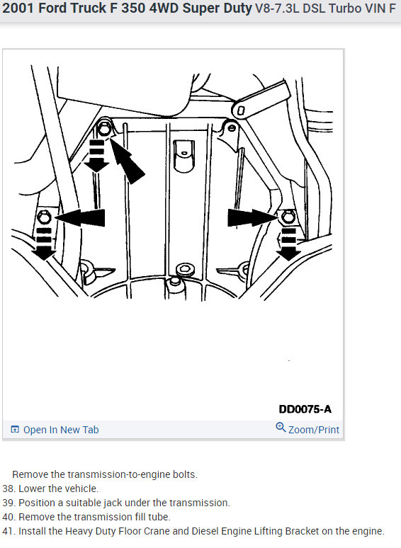

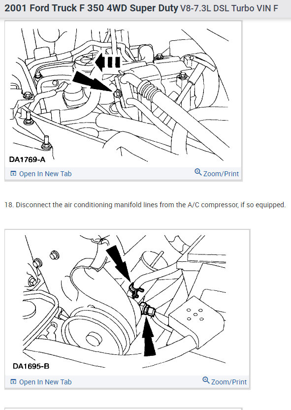

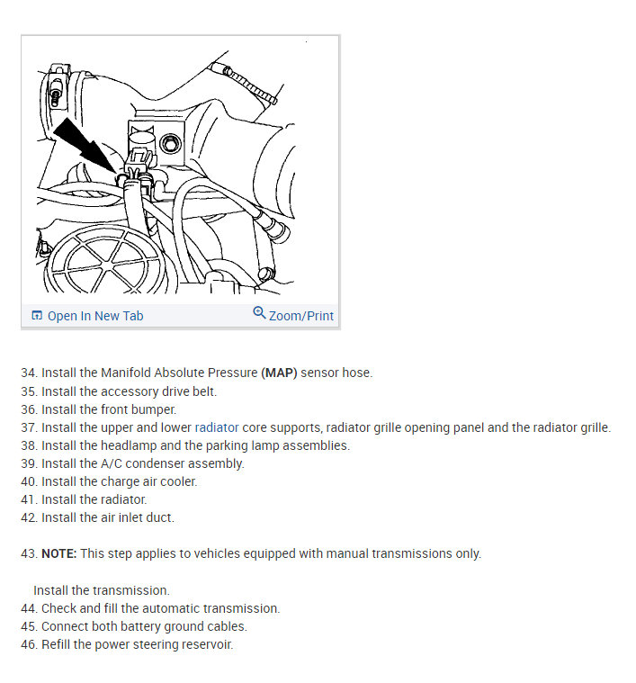

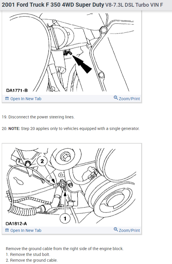

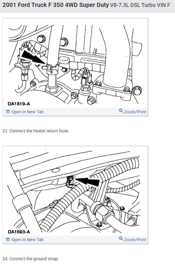

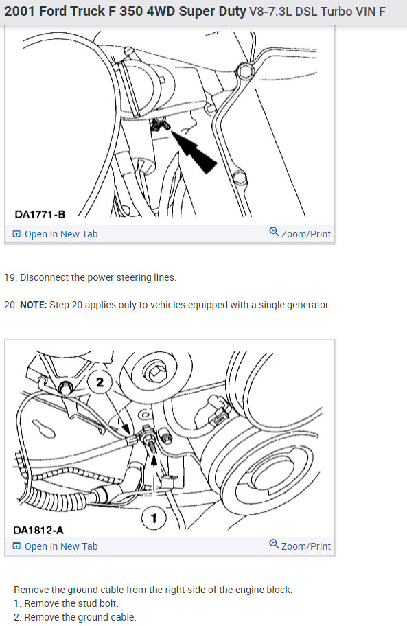

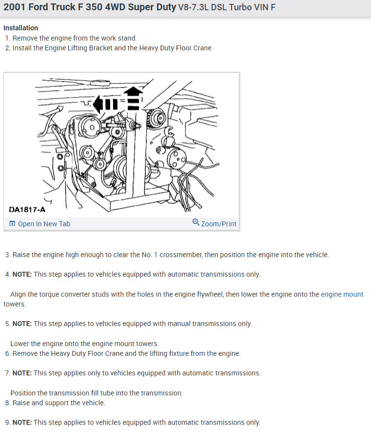

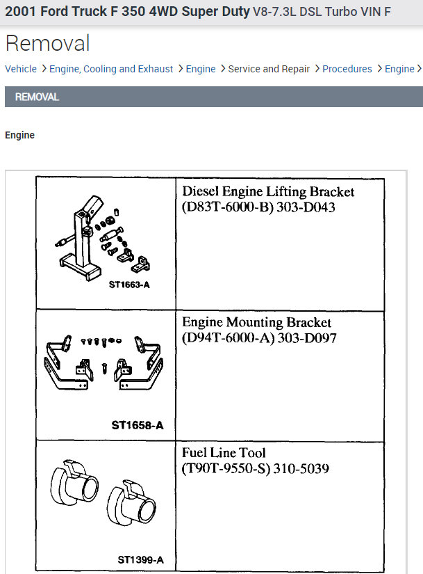

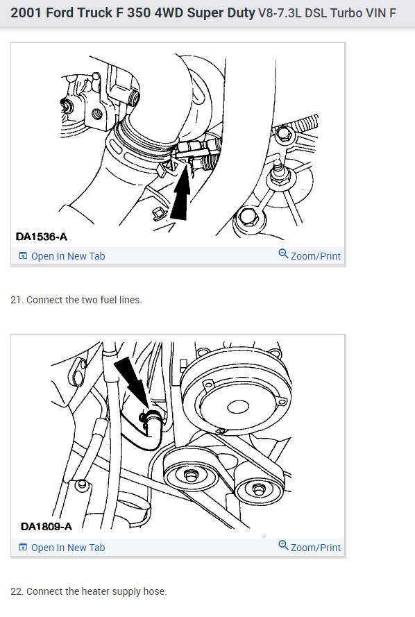

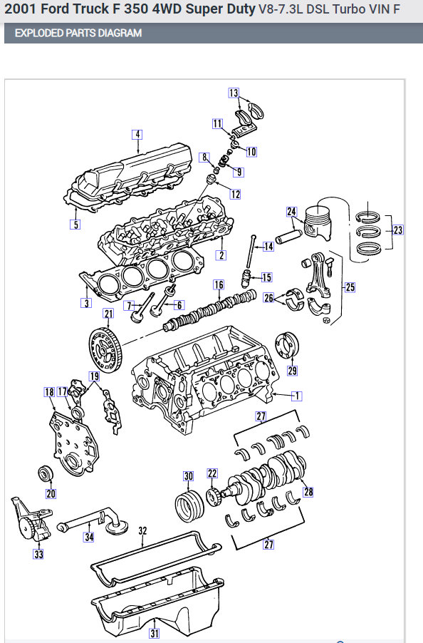

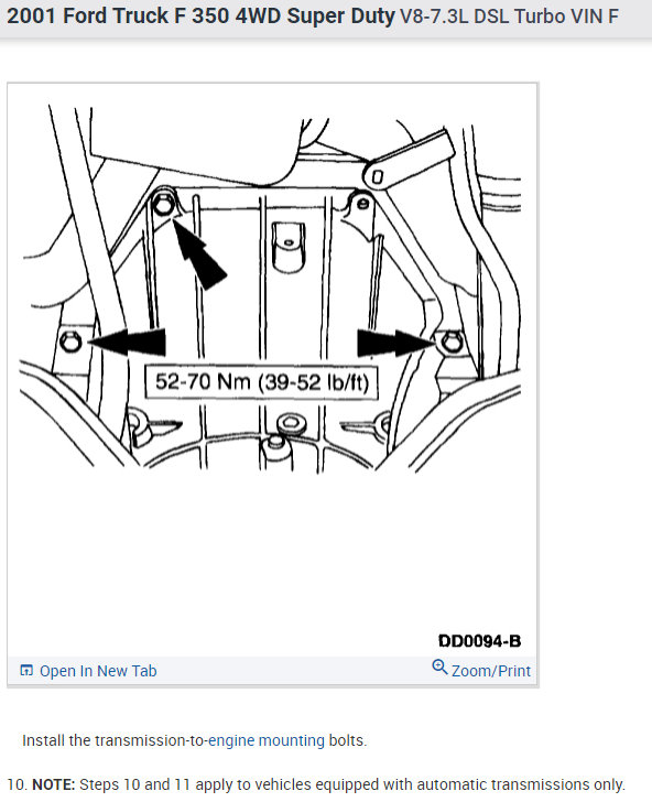

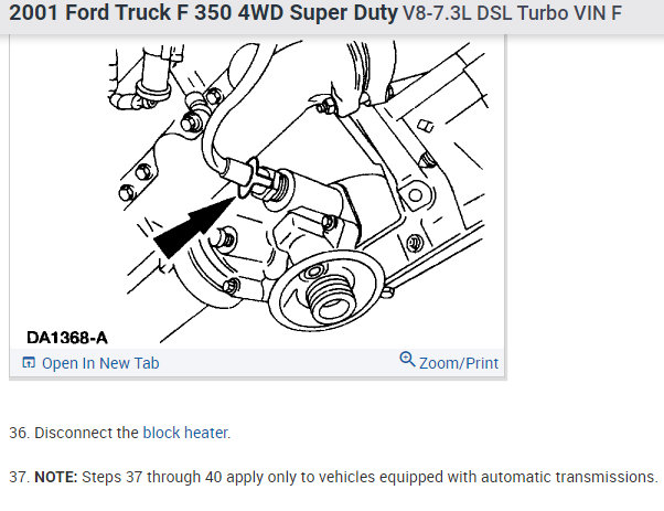

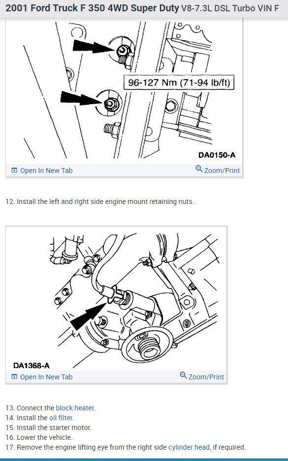

In order to replace the engine you will need to have few specialty tools, including an engine hoist.
I have included all the required specialty tools list as well as the complete replacement instructions.
https://youtu.be/zy1CozLgWUQ
Please let me now of any questions.
