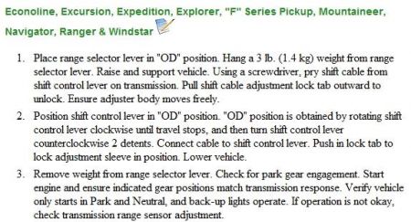

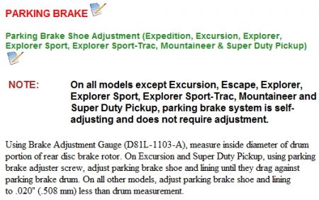

How do you adjust the trans linkage? it sometimes does not engage the park lock. Also how to adg. the parking brake, there is no adj. on the cables. Frank
