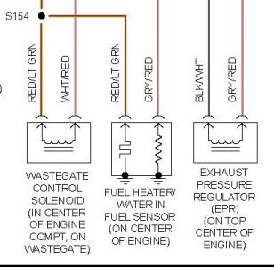

where does it get ground to activate solonoid?
Mar 29, 2010 at 11:49 AM
DAVE H
  • 13,384 POSTS
red/lightgreen wire goes to fuse #30 (hot) in central junction box grey/red wire goes to PCM
https://images.2carpros.com/forum/automotive_pictures/266999_350_1.jpg
