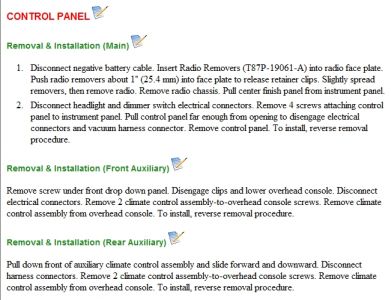

Please give me information on replacing the air conditioner blower switch. thanks

https://images.2carpros.com/forum/automotive_pictures/261618_Noname_2384.jpg
