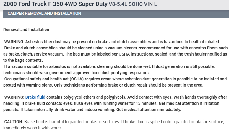

My rear caliper comes loose. One of the bolts come out and I put new one in and about 5000 miles it will do it again. Help
Sunday, January 3rd, 2010 AT 1:35 PM
SQM
  • 6,383 POSTS

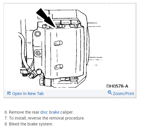

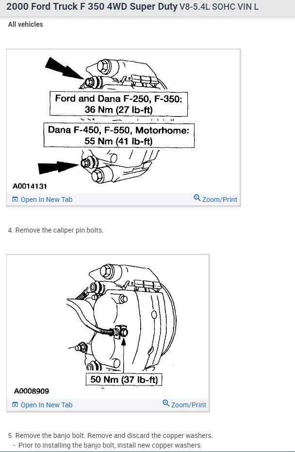

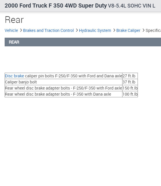

First make sure that the bolts are torqued at the correct specification.
Those calipers slide bolts needs to be at 27 ft. lb.
Also make sure that the threads are in good shape.
If all of those checks out, it will be a good idea to use thread lock to prevent the bolt from coming out due to vibration.
