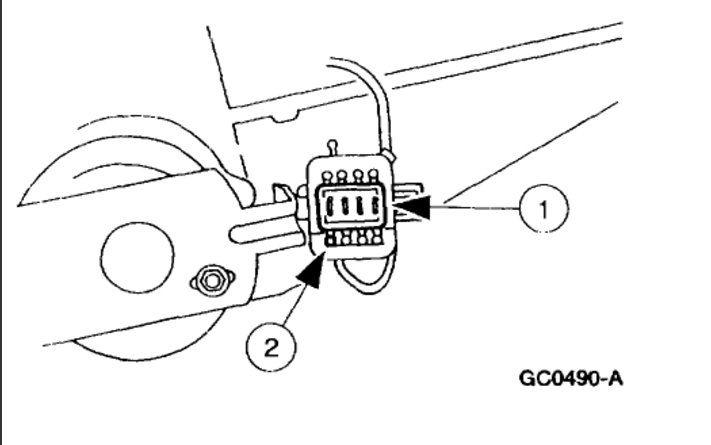

I am having trouble getting my 4x4 to engage. It is done electricaly by switch and I don't know if it is a fuse or something else? Do ya'll might know what it could be?

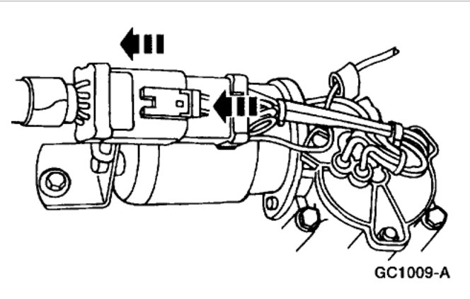

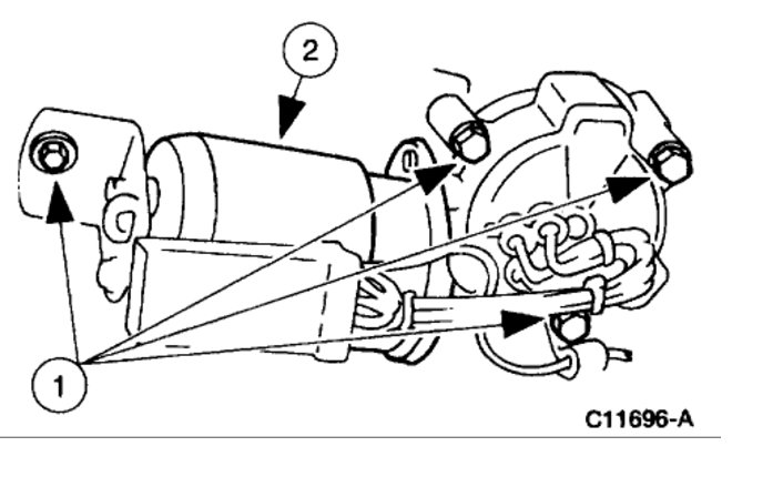

This sounds like the transfer case shift actuator is out. To be sure remove the actuator and see if it moves with the key on move the switch and you should see some movement. Also check the connector for corrosion.
Here is a diagram to help you see what Im talking about. (below)
Please let us know what happens so it will help others.
