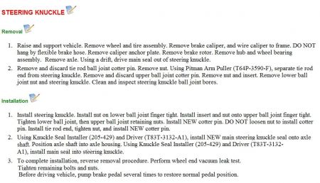

i need to replaiice the bal joints and want to know how to take the knuckle from the wheel bejaind the drum disc plzzz some one help

https://images.2carpros.com/forum/automotive_pictures/261618_Noname_2529.jpg
