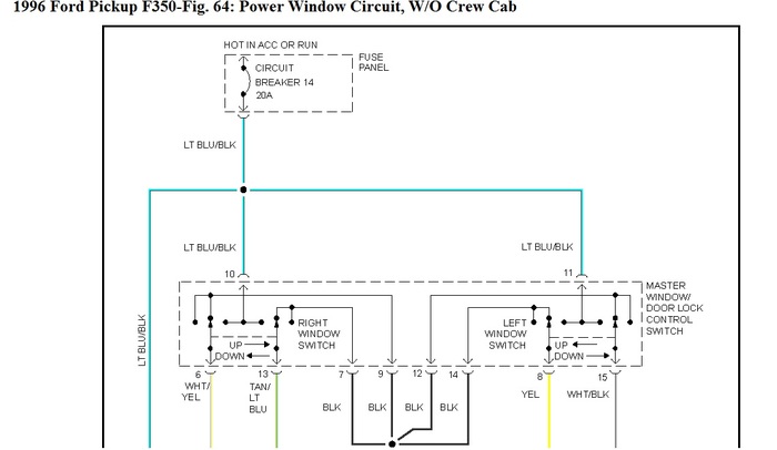

JDL
  • 16,098 POSTS
I agree with Roy. Just take one system at a time and check voltage and ground.
The diagram is for power windows without crew-cab. Do not mean to butt in, I had already copied the diagram, might as well post it.
