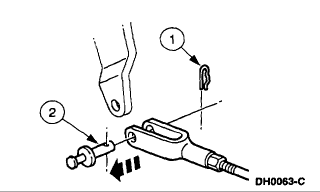

2.Disconnect the adjusting clevis. 1 Remove the clevis pin locking pin. 2 Remove the clevis pin, and disconnect the adjusting clevis from the parking brake lever.( Parking Brake Release Handle Nuts 8-11 Nm (6-8 ft. lbs.)
