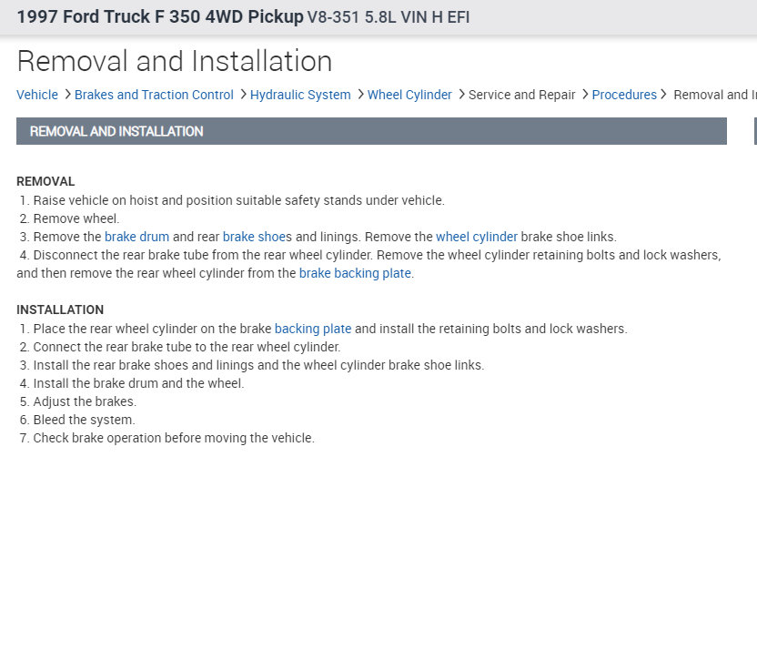

If you are losing brake fluid, then it is due to a leak.

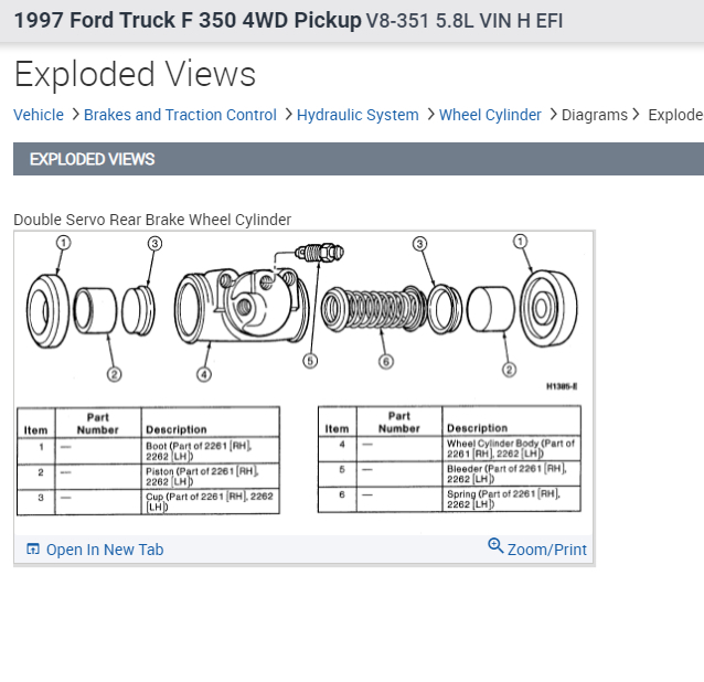

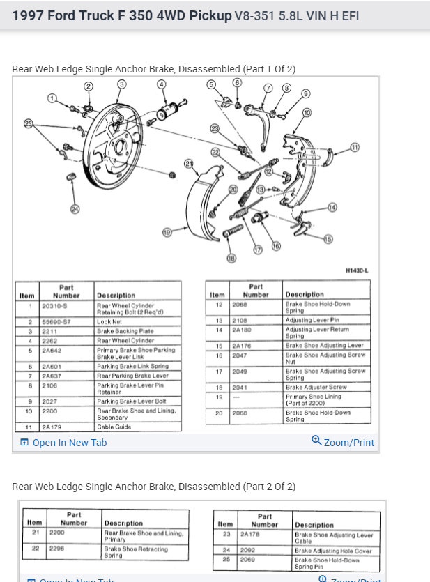

One of the most common leak area is the rear wheel cylinder. Those wheel cylinders have a tendency to leak out of the seal, and that will have brake fluid leaking inside the brake drum. Which can be difficult to see without removing the brake drum.
https://www.2carpros.com/articles/how-to-replace-a-wheel-cylinder

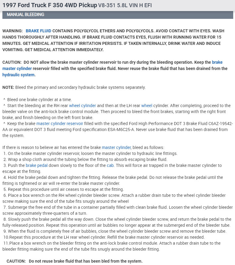

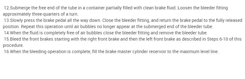

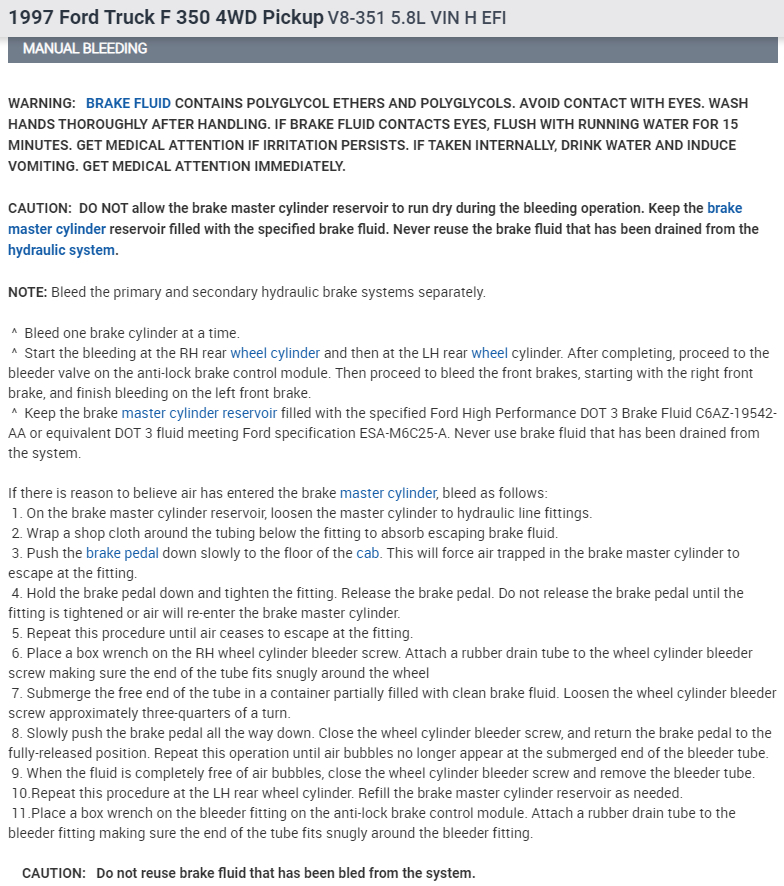

Keep in mind that replacing the wheel cylinders will require the brakes to be bled to purge out any trapped air.
https://www.2carpros.com/articles/how-to-bleed-or-flush-a-car-brake-system
