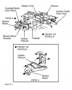

How hard is it to replace the heater core in this year model truck ?

HEATER CORE Removal & Installation Carefully release cooling system pressure by turning radiator cap to first stop. Tighten radiator cap. Drain cooling system. Disconnect heater hoses and plug hoses. See Fig. 1 . Remove glove box for access. Remove Rear Anti-lock Brake System (RABS) module mounting screws and move module aside. Remove 7 screws attaching heater access cover to plenum. Disconnect vacuum source. Leave vacuum harness attached to cover. Remove cover. Remove heater core from plenum. To install, reverse removal procedure.
