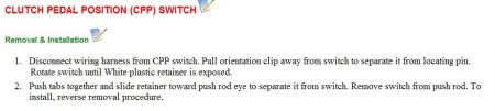

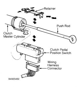

I found the clutch safety switch--how do I remove it from the shaft thru the firewall and should it be loose on the shaft?
Tuesday, October 19th, 2010 AT 6:28 PM
BLUELIGHTNIN6
MECHANIC
16,542 POSTS
No it shouldn't be loose , follow steps and diagram below to replace it.
