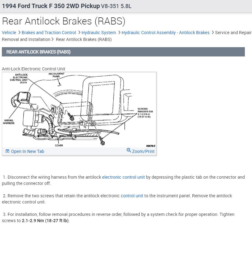

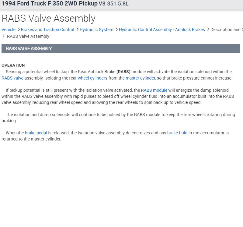

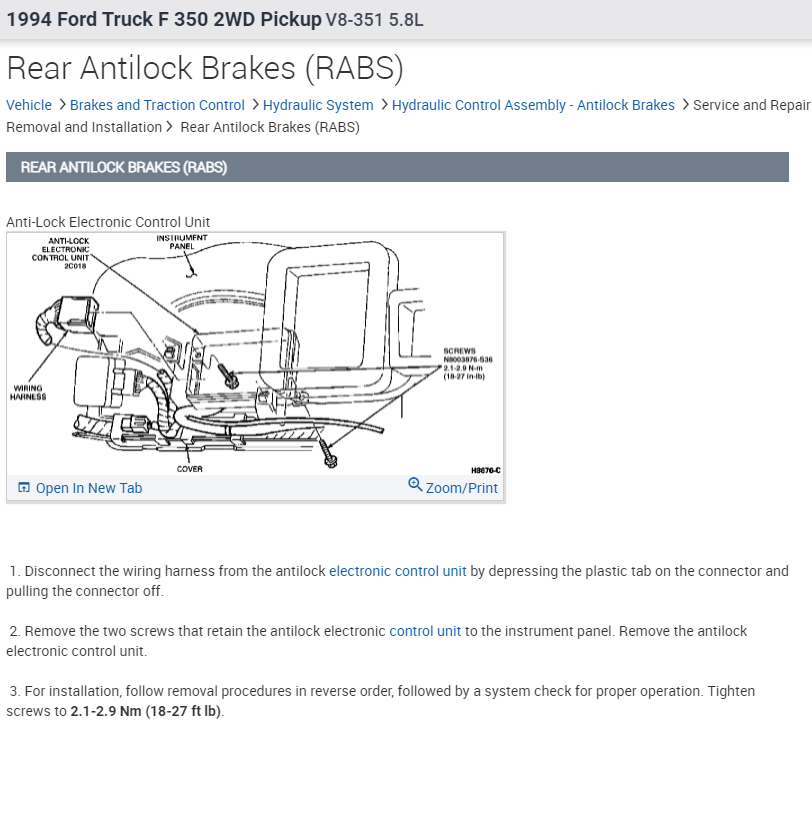

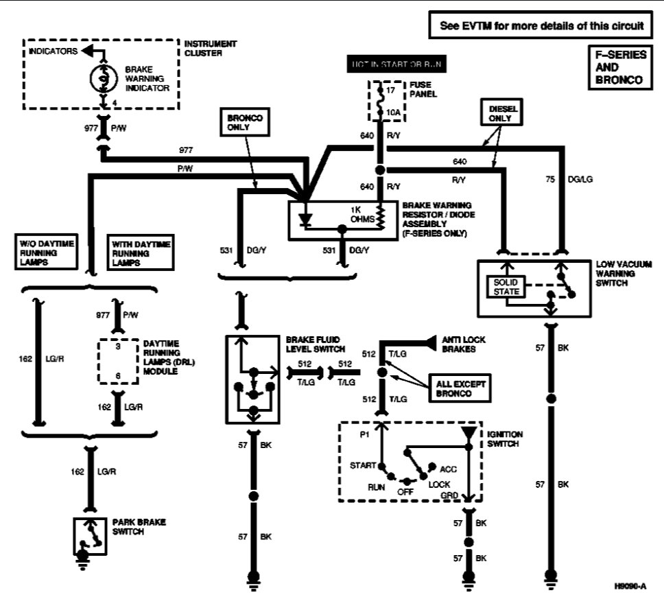

This could be an issue with the ABS module. A malfunctioning module can lock up the brake.
Best course of action would be to retrieve the ABS codes. As that can help with, the diagnostics.
Here is a helpful video:
https://youtu.be/rTtAnsOlZU4
