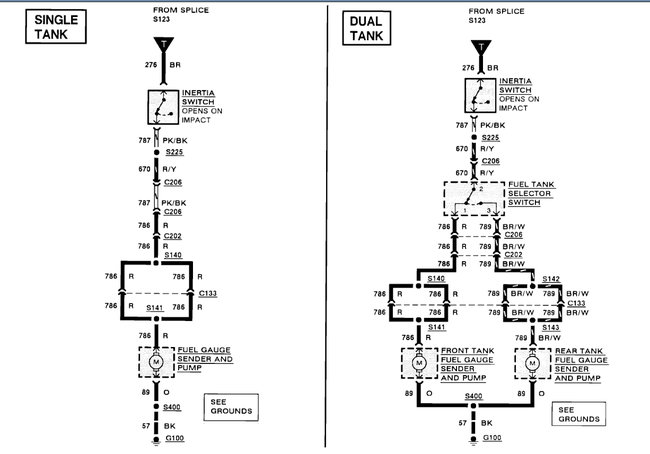

Ok. I just bought this truck. I have dual tanks. After I got it home I was playing around with it a little and I decided to switch the tanks to see how much fuel was in the rear tank. I flipped the switch and the truck stalled 2 seconds after. The rear tank was empty. So, I flipped the switch back to the front tank after I had shut the key off again. (The front tank had a half tank) Then I tried starting is again and it would not start. I'm figureing that the selector valve is now vapor locked or stuck somehow, the relay for the front tank had coencidentally went bad at that moment, or the fuel tank switch may have also coencidentally went bad at that point. I am not sure if there is two pump relays for this truck though. My 88' f-150 had dual tanks and had two relays; one for each tank. I couldn't get a chilton manual that could help me with this dilema. I am assuming that there is only one relay for the fuel pumps though. I think it is the green one. My 88' had a green relay and a brown relay. I would for sure like to know if there is more than one relay so that I can eleiminate that. I would also like to know where the selector valve is for the tanks. I pry should also add that when I use the rear tank I can hear the pump kick on for the second that it should to prime the line. When I try to use the front tank the pump doesent kick on but I can hear something click. Which is pry the relay. Thank you.
Jan 31, 2008 at 12:00 PM
BAREFOOTBOB88
  • 60 POSTS
Well now, to answer my own question... 1.) I have figured out that there is only one fuel pump relay for both pumps/tanks ( it is the green on on the driver side fender wall ), 2.) there is no external selector valve that switches the tanks. 3.) The fuel pumps themselves have a check valve on the outlet side of the pump that delivers fuel to the engine. When the pump is energized by selecting the tank the pressure in the pump builds up behind the check valve and forces it to open allowing fuel to be pumped to the engine.
THERFORE.... I have one of two problems... the lesser of the two evils is that my selector switch is pry bad and needs replaced. Or the greater evil, my fuel pump needs replaced because the outlet check valve is stuck shut.Which means I have to figure out where I'm going to stick 9 gallons of gas in order to drop the tank. Since I don't hear the fuel pump kick on when I try to use my front tank I am hopeing its the tank selector switch. I will post my findings.
Jan 31, 2008 at 2:26 PM
BAREFOOTBOB88
  • 60 POSTS
It was the tank selector switch after all. I pulled the one out of my 88' f-150 and used it in my f-350. I flipped the switch to the front tank and turned the key on. Sure enough I heard the pump knick on and the truck started right up. The switch leg for the pumps power was not closing and the switch leg for the fuel gage was closing. Thats why the pump wouldn't work but the fuel gage still worked for the front tank. :D

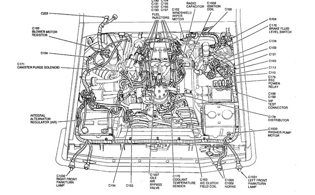

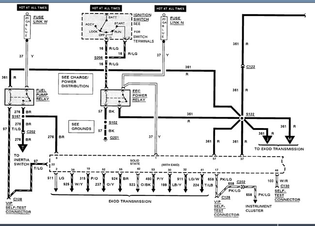

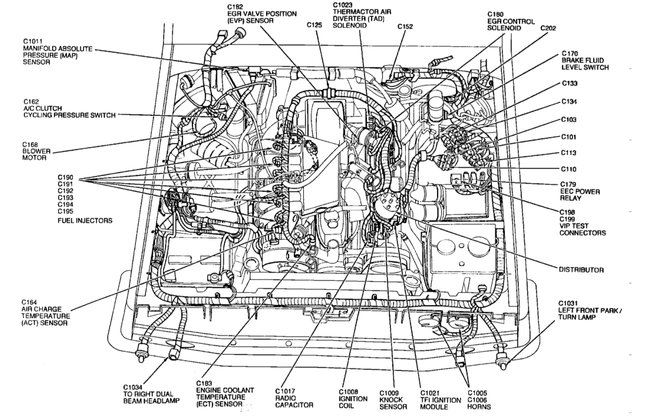

  • 75,992 POSTS
Check the computer if its properly grounded- The computer energizes the fuel pump relay then power goes to the inertia switch thru the brown wire then fuel pump. Here is the location of the fuel pump relay in the diagrams below.
LH Side Of Engine Compartment, On Relay Bracket. Fuel pump relay is next to the EEC Relay.

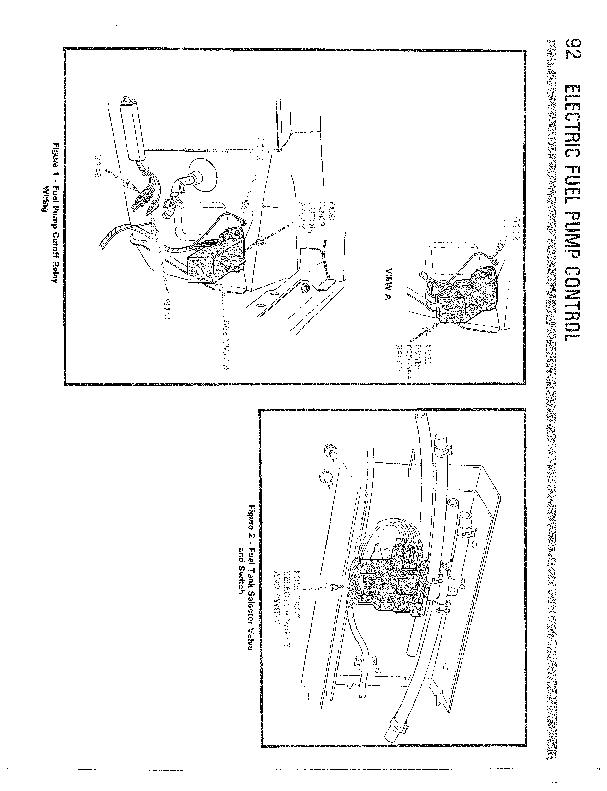

  • 75,992 POSTS
Test the fuel pressure and also see below
https://images.2carpros.com/forum/automotive_pictures/12900_fp1_2.jpg
https://images.2carpros.com/forum/automotive_pictures/12900_fp2_2.jpg
https://images.2carpros.com/forum/automotive_pictures/12900_fp3_1.jpg

MHPAUTOS
  • 31,937 POSTS
Check for a fuel pump relay that is stuck in the on position, start here.
Sep 11, 2020 at 4:28 AM (Merged)
SETH1583
Ok thank u, I'll do that. Where is the relay located?
MHPAUTOS
  • 31,937 POSTS
It should be under the shield at the air cleaner support bracket, this info is from Mitchell 1 Data base.

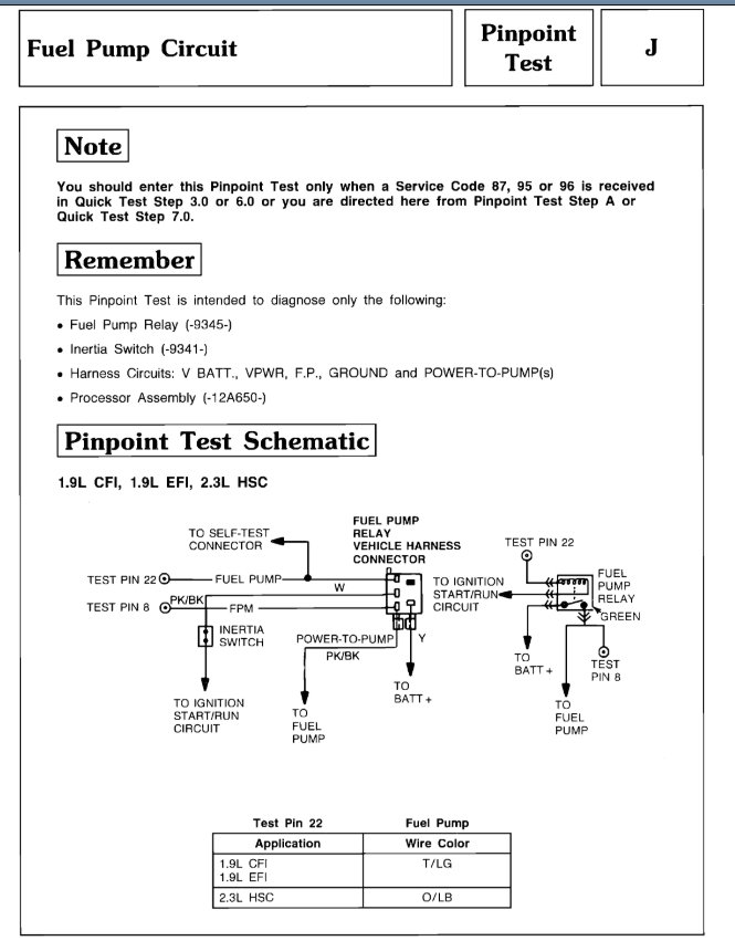

HMAC300
  • 48,601 POSTS
check the brown wire that goes to the inertia switch then see if inertia switch has power on both sides it could be just a bad switch. It could also be a bad relay as well. if no power coming out of brown wire at relay try replacing it with a like relay and see if it works. it can also be a bad ground on fuel pump. I am assuming this has dual tanks so it could also be the tanks switch I am sending that along on how to check for that.
Applicable to: 7.5L/V8-460
Check out the diagrams (Below). Please let us know what you find.
Cheers

HMAC300
  • 48,601 POSTS
unless someone has changed the wiring or it may be old as well. it should be brown on one side and pink on other. regardless check for power on both sides if power on one but not the other then the inertia is bad or the switch has popped.or you can use an ohm meter and see if you get 0 through both. Here are the engine and fuel pump wiring diagrams with the guide to help you do some testing.
Check out the diagrams (Below). Please run this test and get back to us.
Cheers

FORDMAN
1989 ford f350 with 460 engine. something has shut the power off to fuel pumps and injectors. I put a jumper wire from battery to relay plug and fuel pumps are sending gas to rail but won't crank. I can spray starter fluid in air intake and it will run. My book says computer turns power on and off based on rpm and vaccum but does not say where these sensors are. mileage is around 120,000. I bought it not running and have tried everything I know. Any help would be appreciated. Thanks
Sep 11, 2020 at 4:29 AM (Merged)
2CARPRO JACK
  • 11,533 POSTS
First thing of course is to check all the fuses and fusible links in the underhood power center. If all are ok, then test for power to the EEC relay.It is the main power supply for the ECM.Check those and get back to me
FORDMAN
I checked all fuse links. I did a voltage test on the battery-12.77, eec relay coil side-12.45, side to be switched-3.46, fuel pump relay coil side-3.02, side to be switched 3.43. There is not enough voltage at the fuel pump relay to activate coil. If I put jumper in relay plug to fuel pumps the 3.43 voltage is not enough to run fuel pumps. I can run jumper from battery to same plug and fuel pumps will run but won't crank because no power to injectors.
