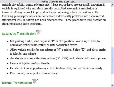

I have a 460 that was running fine until I disconnected the battery to replace a turn signal switch. After reconnecting the battery the engine started running rich, the tail pipes turned black, and whenever I stop and put it into park it dies. Do you have any suggestions.

Try computer relearn see below
https://images.2carpros.com/forum/automotive_pictures/12900_computer_relearn_ford_generic_1.jpg
