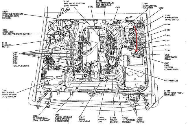

Where is the fuel pump relay switch located?
1989 FORD F-350
MOUSIE
1989 Ford F350 98000 miles
Dec 13, 2007 at 9:04 AM
TOBYU
  • 89 POSTS
The relay should be a green one on the driver inner fender well.
Dec 13, 2007 at 6:38 PM
  • 55,112 POSTS

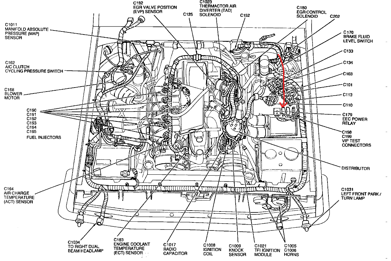

LH Side Of Engine Compartment, On Relay Bracket. Fuel pump relay is next to the EEC Relay. See the red arrow below. Check out the images (below). Please let us know what happens.
