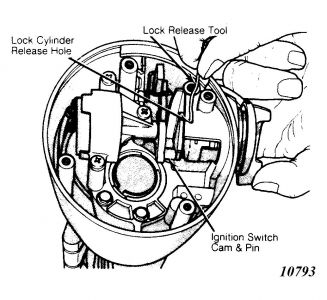

INSTRUCTIONS, IGNITIION SWITCH / LOCK CYL.
REPLACEMENT WITH TILT COLLUMN.
Jul 20, 2008 at 11:18 PM
BMRFIXIT
  • 19,053 POSTS
IGNITION SWITCH & LOCK CYLINDER -1983 Ford Pickup F350 Page 1 of 1 Removal (All Other Models) 1.On non-tilt column models, remove steering wheel and trim pad. Place gear selector in "P" on automatic transmission models (any position on manual transmission models). On all models, insert key and turn cylinder to "ON" position. 2.Insert a 1/8" diameter pin in hole on outside of steering column casting near hazard warning button on tilt models. Insert pin in hole near base of lock cylinder on non-tilt models. On all models, depress pin and pull out on lock cylinder to remove.
