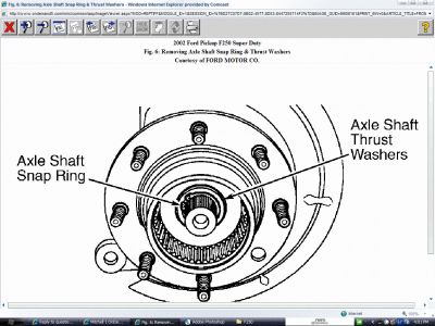

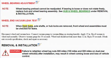

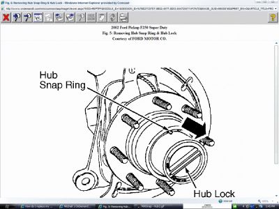

I have a Diesel 2002 F250 Super duty, auto trans, 4 WD, with ABS and have a front wheel bearing going out. I am thinking of doing this myself. Anyone have any experience with this and how is the best way to replace this? Will the ABS need any special care? Doing the brakes on this at the same time.
Thanks
Nov 15, 2007 at 2:05 PM
MERLIN2021
  • CAR REPAIR CONTRIBUTOR
  • 17,250 POSTS
This is not your father's Oldsmobile...Here you must replace the hub and bearing, and then Vacuum test the hub! Here's how..
