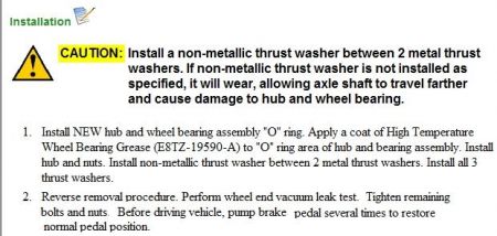

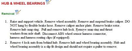

need diagram of parts and info on how to install new seals and wheel bearing on front passenger side. 4wheel drive with 4 wheel anti-lock brakes 5.4l engine

https://images.2carpros.com/forum/automotive_pictures/261618_Noname_1932.jpg
https://images.2carpros.com/forum/automotive_pictures/261618_Noname2_620.jpg
