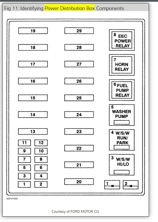

This morning when I started my truck none of my gauges were working, they are all stuck on zero. Is this possibly a fuse issue or somthing more that I am going to need to take it to the shop for. I tried turning it on & off a few times but that did nothing. The light for the instrument panel is working as well as the turn signals & I did see the airbag light come on when I started it. But the gas, temp, speed, rpm battery, & oil are all registering nothing as if the truck was off. Any help will be appreciated.
Thanks - Jessica
May 2, 2007 at 12:37 AM
  • 55,682 POSTS

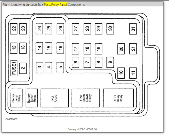

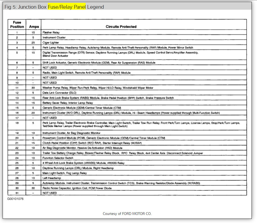

Yep you should start with the fuses, here is a guide to help you see what to do.
Jan 30, 2018 at 8:28 AM
REDJESS
Thank you it was fuse #2 15 amp. This site is the best!
