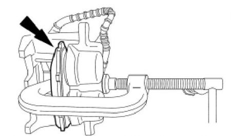

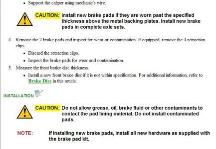

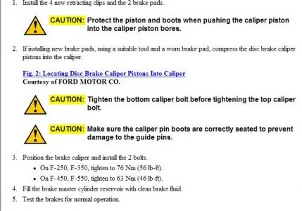

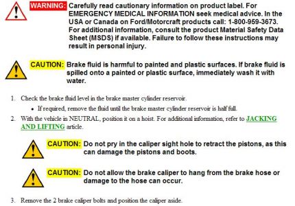

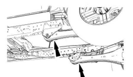

I new to the auto repair market and I would like to repair my brake pads on my 07 Ford 250 PSD. I have never changed the pads on a vehicle and would like to seek advice on how to perform this repair. Can anyone tell me how to perform front brake pad replacement. Thanks

https://images.2carpros.com/forum/automotive_pictures/261618_Noname_46.jpg
JACKING POINTS
https://images.2carpros.com/forum/automotive_pictures/261618_jackpoint_1.jpg
https://images.2carpros.com/forum/automotive_pictures/261618_Noname2_15.jpg
https://images.2carpros.com/forum/automotive_pictures/261618_Noname3_8.jpg
FIGURE 2
https://images.2carpros.com/forum/automotive_pictures/261618_caliper_1.jpg
