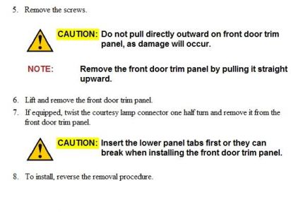

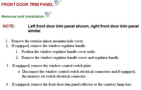

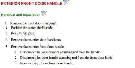

I am trying to put chrome covers on my 2005 F250. But the handle cover is to close to the door to allow the stick on covers to pass by. Is there a way to move the handle? And how do I get the door panel off?

thanks i have emailed the diagrams to you and also i edited them and reposted them below, hope that helps..
