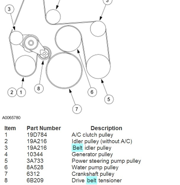

JDL
  • 16,098 POSTS
Note the diagram for single alternator serpentine belt. See #8 that is the tensioner, looks like a drive cavity, don't know the size, 3/8/or a 1/2. Use a long handle rachet or breaker-over, whatever is easier, push to release tension.
