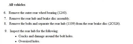

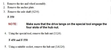

I am trying to replace the front hub and I am not sure of the correct way to get off.

Hello and thanks for donating
below are the proper removal steps for your vehicle's front hub.
